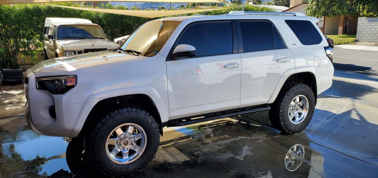

Looks great! Do your fronts not eat the fenders at full compression though? It looks tight.
Couldn't tell you, never wheeled it that hard and it's not like that anymore. You'll need longer bump stops to stop rubbing even where you're at now with your current tires. IFS is much totally different from solid axle. With IFS, the wheel travels straight up into your fenders. With solid axle your wheel curves as it compresses making stuffing the tires a lot easier.

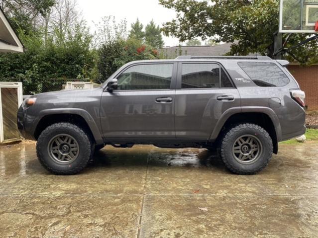

Just added 285/70/17 KO2’s and SCS Stealth 6 to 2020 ORP w/ KDSS. 6112/5160/T13/SPC UCA gets installed in a couple days. Lots of rubbing with stock suspension. Will update with amount of trimming needed after lift install.
Get rid of the front mud flaps and do the fender liner mod. More that likely all your rubbing will be solved. Wherever you rub now, you will still rub after the lift install.

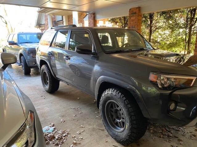

lift and uca installed. clips set at 5. thinking about bumping up 1 more clip. front mud flaps removed. still rubbing on full turn, but fine for driving around town. getting bmc next week.

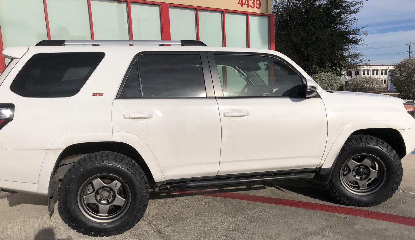

stock SR5 with SCS F5's and 255/75 BFG Ko2's. Discount guy said slight rubbing while turning in reverse. I need to check. I'll remove mud flaps tomorrow. Getting a 6112/5160 lift this week.
