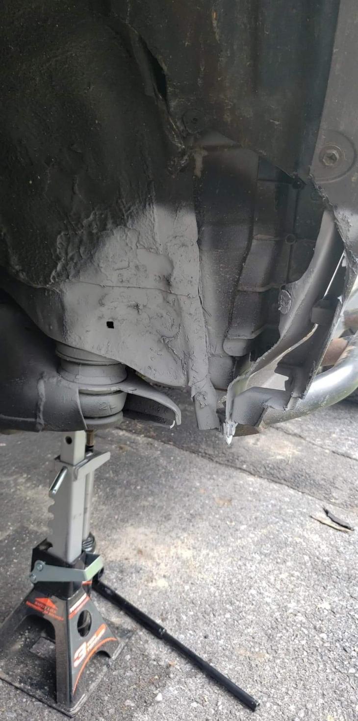

I just put 35x12.50x17 on, suspension jba uppers, kings coil over, dirt king lowers, scs 17x8.5 4.30 -12 back space. Needed spacers cause tires were rubbing on uppers, went with bora .75 spacers.
All the gray area in the pic needed to be touched, pound back the firewall, as you can see body mount chop is cut back past half of what it originally was. Pinch weld folded over and flattened, plastics trimmed fender trimmed on the inside. I used gray primer as I was testing so you can easily see where its rubbing.

sweet thanks. how much lift are you running?
I dont have exact measurements but came from OME heavy 3 inch to kings 2.5 coil over with 700# coil
So I want to say 2.5-3
Also I have a shrockworks front bumper no issues upfront
