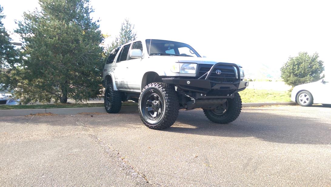

Here's my 99 with 265s and 3" Toytec lift
417d14dd-08d7-4266-9081-02409a05ac62_zpsd2a09624.jpg~original

305/70r16 @ 28psi
City 14-15mpg
Combined 16.9mpg
