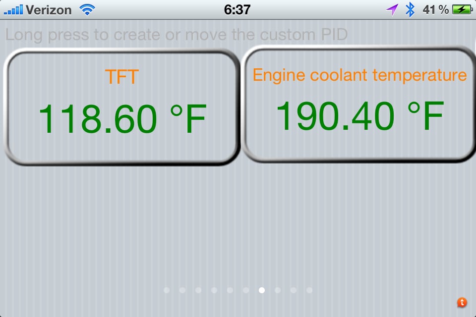

Well, it works. This was on my drive to work this morning.
That's awesome, first person I've seen pull this off with an Iphone! I wonder if you could use a wifi adapter instead though so I wouldn't have to jailbreak my phone? I'm not sure why I wouldn't just jailbreak it at this point, but I'm asking the question anyways.
What else does that software do? Scan & clear OBD2 codes? Can you datalog? I've never heard of "engine link".

It should work just fine with the wifi adapter. I just took the Bluetooth route because I didn't want to disconnect my phone's data connection when it connected to the wifi adapter.
It pretty much displays reported engine parameters like MAF flow rates, coolant temp, vehicle speed, etc. It does report and clear trouble codes. As far as I can tell, it doesn't data log.
How is the latency? My setup (wifi) is practically unusable the latency is so bad, maybe 10 sec +/-. I might be inclined to pick up a BT adapter now since I've recently jail broke my phone anyways. Would be curious to see if the wifi is the issue vs BT.
Care to share the pid info/process? I too have engine link but I pretty much shelved due to the latency issue.

If I had to guess, I think you have a bad wifi-to-OBD adapter, and that is causing you problems. My adapter doesn't get hot. I have no idea if it stays on when the key is "OFF". I drive the 4Runner as my daily driver, and it hasn't drained the battery. There's a slight lag in the latency, but nothing terrible.
As far as the custom PID information, this is what I used:
Header:0
ModeAndPID: 01b4
Formula: A*(9/5)-38
Min: 0
Max: 350
Unit: °F
Description: TFT (you can call this whatever you want)
