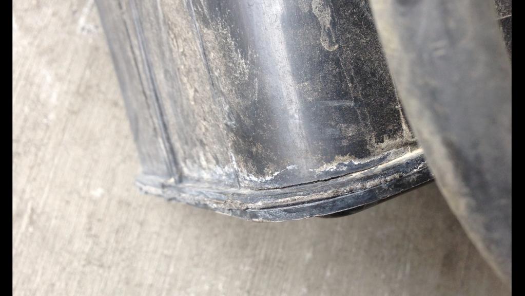

Well, I pulled my canister and sure enough the seal at the bottom is cracking away, so I caked it with gasket maker (brown) hopefully it holds up and does the trick.

As I mentioned, I found that that seal around the base of the canister was deteriorating, so I used brown RTV to seal it.
So far I have traveled over 200 miles with no light, however last time I made a "fix" it went over 800. I guess we will have to see.
Here is what it looked like. As you can see I just threw caution to the wind and sealed the whole base.
I too had a cracked base like ajonesnv. I borrowed some roof sealant and sealed the entire bottom too. I pulled the fuse and relay for the ECU and let it all sit for a day. That was about 300 miles ago and I just passed my smog test, and I never used a code reader to clear it.
