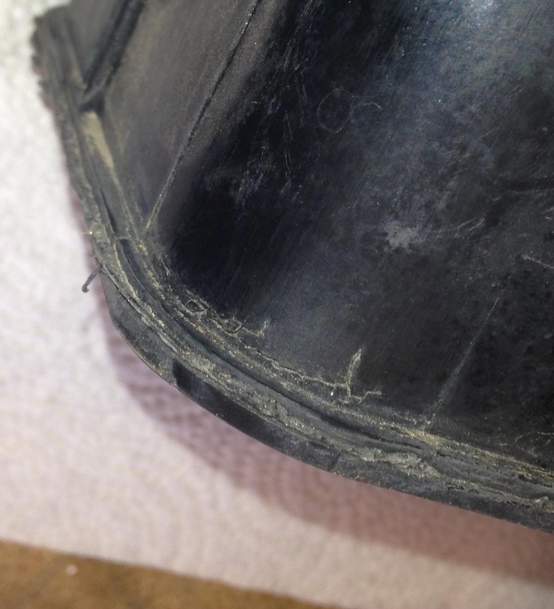

All the time and money spent replacing all the vacuum lines and VCV's and I am pretty sure I can do a tech writeup based on cheapest to most expensive fix for the P0446 code. Anyway my issue boiled down to this...

It comes out very easily 3 bolts. You do have to pull the lines from the VSV's, but they all come off very easily. I would recommend sealing the canister prior to messing withe the VSV. Also you can check the VSV with a simple 9v battery and two leads.

Started looking at this thread and first of all thanks to everyone that put up so much useful content. First thing I'll do is pull the canister and VSV assembly out. I'm going to test the VSV first with the battery test. If it's good then great, if not, I'll see what condition the canister is in and go from there. I'll try to repair the canister as much as I can if there's any cracks like shown on this thread. If the canister is beyond repair and the VSV is also damaged then I'll order the entire assembly. I'm really hoping that replacing the VSV alone (if needed) and fixing any cracks will solve my issue.
