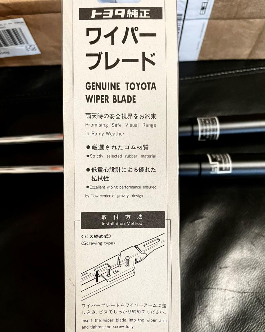

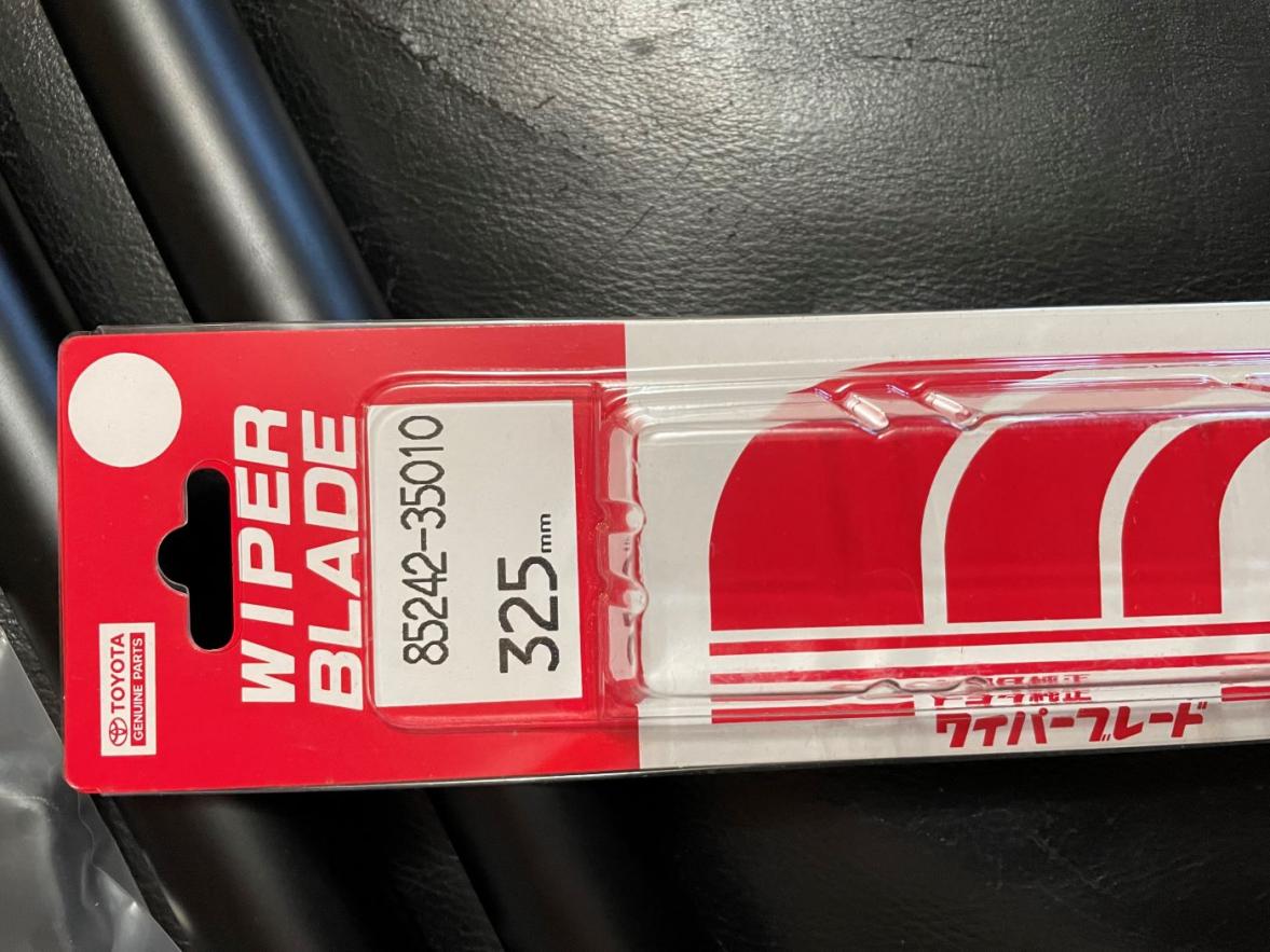

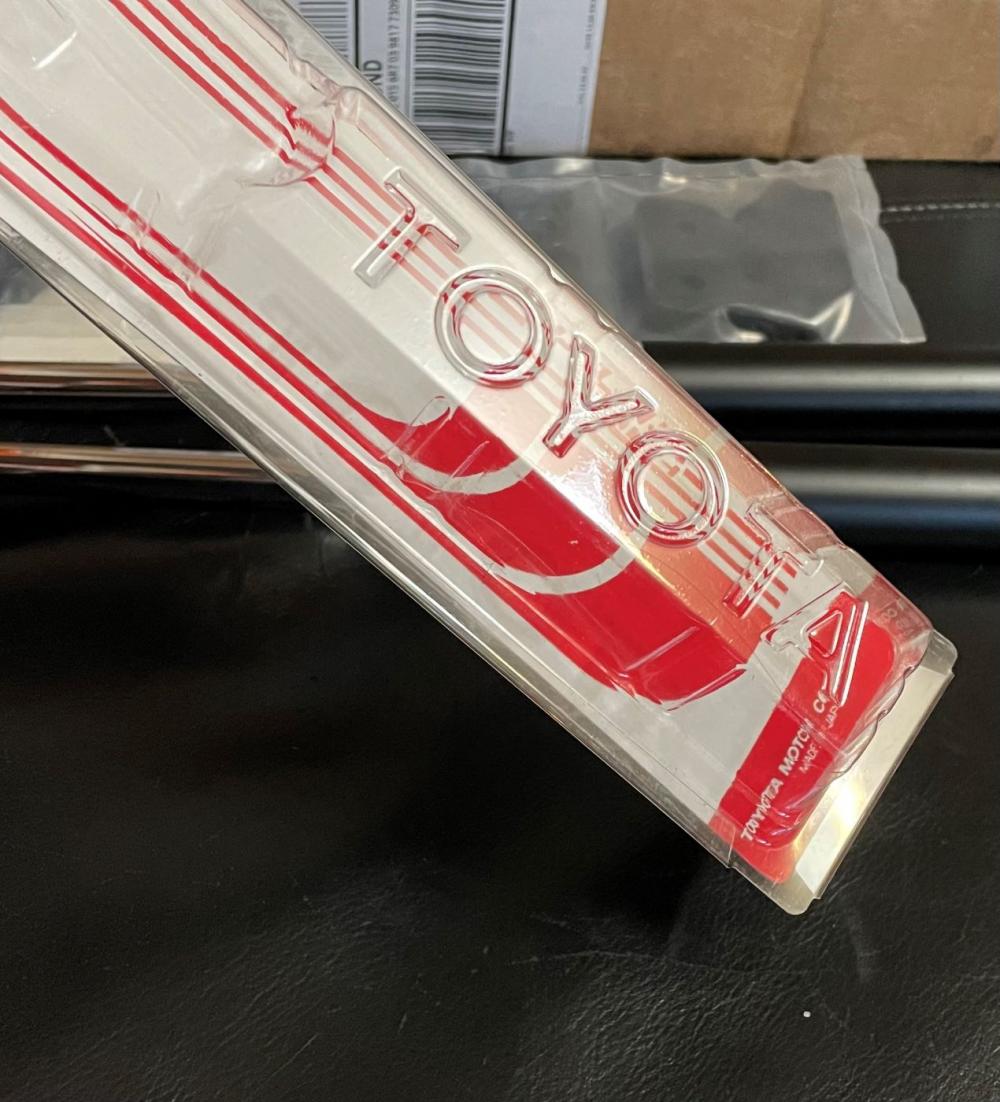

Got my cold-specs last night and I am glad I spent the extra $ on the Toyota parts. Since the dealer was doing free shipping I treated myself to a rear wiper assembly (no pics - I put it on right away) to go along with the replacement rubber bumper I had laying around. Thanks again to Leon for the head's up on the struts.

Much JDM, very OEM.
I kid. I do like the packaging on our rear wiper blades though. It's pretty cool I think.
