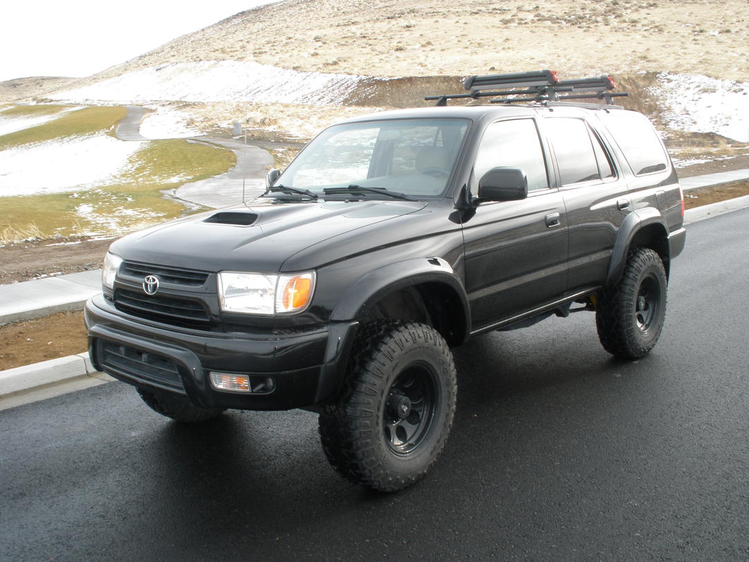

Any pics of your rig with those tires on it?

The Duratracs have a nice agressive look but with very good on-road manners and very good hydroplane resistance and good rearend recovery in the snow even in 2wd. They emit average noise levels for an A/T tire but nothing the radio doesn't cover up. Off road they've been very solid and no complaints here either for me.
With the Duratracs I don't feel I sacrificed performance for looks.
I do see their price has risen considerably over the last year (about $35/tire) and pretty much match BFGs price point.
