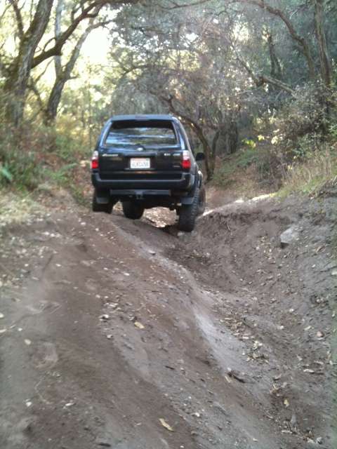

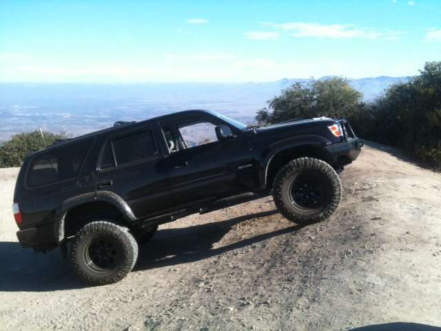

I am running load range E and absolutely love them. With my setup the ride is not stiff at all. They have gotten me through some pickles in the snow and on the trails. A couple shots from Hollister Hills:
