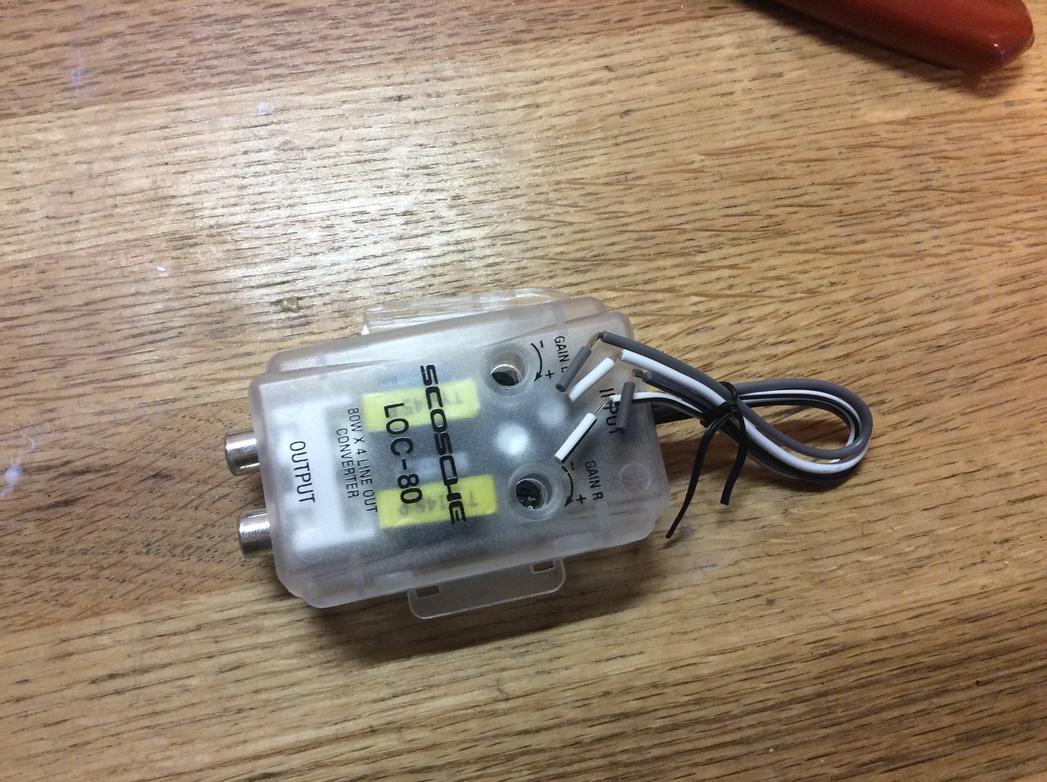

What do you recommended for output to the AMP? From your pictures it didn't appear that there were RCA outputs on the back of entunes factory deck, Thanks Payton.
Does the entunes deck have RCA outputs? What do you recommend for the best signal to the subwoofer AMP?

Hi Paytonious,
You can pickup one of these LOCs; short for Line Output Converters! It's purpose is for your convenience to connect using a pair of RCA's into your amp's inputs from the L & R 'High-output' speaker wire outputs of the audio system... very easy, "see below":

Tap the RCA adapter into the deck or existing speaker wire run?

Where do you recommend taping into the audio for the RCA adapter?
It's purpose is for your convenience to connect using a pair of RCA's into your amp's inputs from the speaker outputs of the audio system... very easy, "see below":

Is it best to tap into the entunes deck for the RCA adapter or existing speaker wire run to the back door?

Where do you recommend tapping into the audio system for the RCA adaptor? Is there a location in the back speaker wire run that you know of?
Sorry Paytonious,
I should have explained myself more thoroughly... Whenever an audio device doesn't have low (signal) level outputs on it's rear control panel, the L & R 'High-level' speaker outputs can be substituted as an alternative. You'll simply grab the L & R 'front channel' speaker output wires from the headunit and tie them into the high-level input wires of the LOC device. This module will convert the high voltage output speaker signal from the HU to a conventional 2Vac pre-amp out with standard L & R RCA's for a convenient 'Plug-&-Play' set-up! Rgds!
