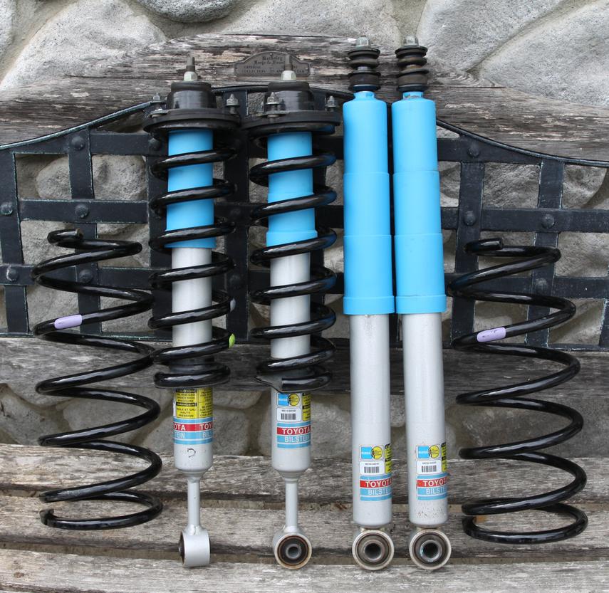

Just bought my fj springs and shocks to add to my 07 sr5 v6 4wd and my ? is what size toytec spacer to get so my running boards are level. 1/4" or the 3/4" ??? I don't want them to point up. Thank you

I'd say the 3/4" Toytec spacer. I have that spacer with FJ springs in the front only, and it's pretty level, just a tad bit of rake left. I'm happy with the setup, it's been great thus far. One thing to note, you'll get ~1" out of that Toytec, but still this shouldn't leave you nose high.

I remember you said before that you liked the stance of mine, I have the 1/4" spacer w/ front & rear FJ springs with no spacer in the back. I think 3/4" will make the running boards a little too high in the front.
You realize the strut on the left side of your pic goes on the left side of your T4R (I am pretty sure)? Read Ark Swamp's install posts for further clarification. 1/4" spacers will do what you want for sure. The 1/2" thick spacers put it on the ragged edge if the running boards are your focus. Just my 2cents.
