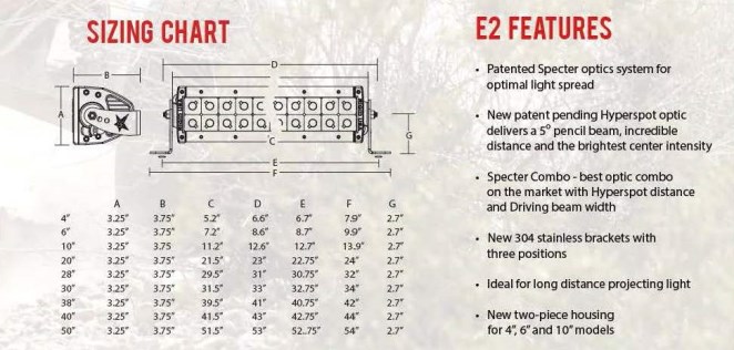

Agree with [MENTION=103267]Saker[/MENTION], it looks like 30" Rigid E2 Combo Rigid E-Series LED Lights | Rigid Industries
Don't think a 40" will fit, but no way for me to confirm as my gill is different (2012). Best thing to do is grab a tape measure and measure width of grill opening, that will give you a good idea what will possibly fit.............TAPE MEASURES DON'T LIE!
Column "C" is the actual width of LED light housing

It may be possible to fit a 38" bar using brackets [MENTION=127657]codyHTX[/MENTION] is referring too, except reverse brackets so mounting point is under light bar instead of extending outward (as picture above) may allow for better mounting surface...........it'll be a tight fit, but that's a good thing!
