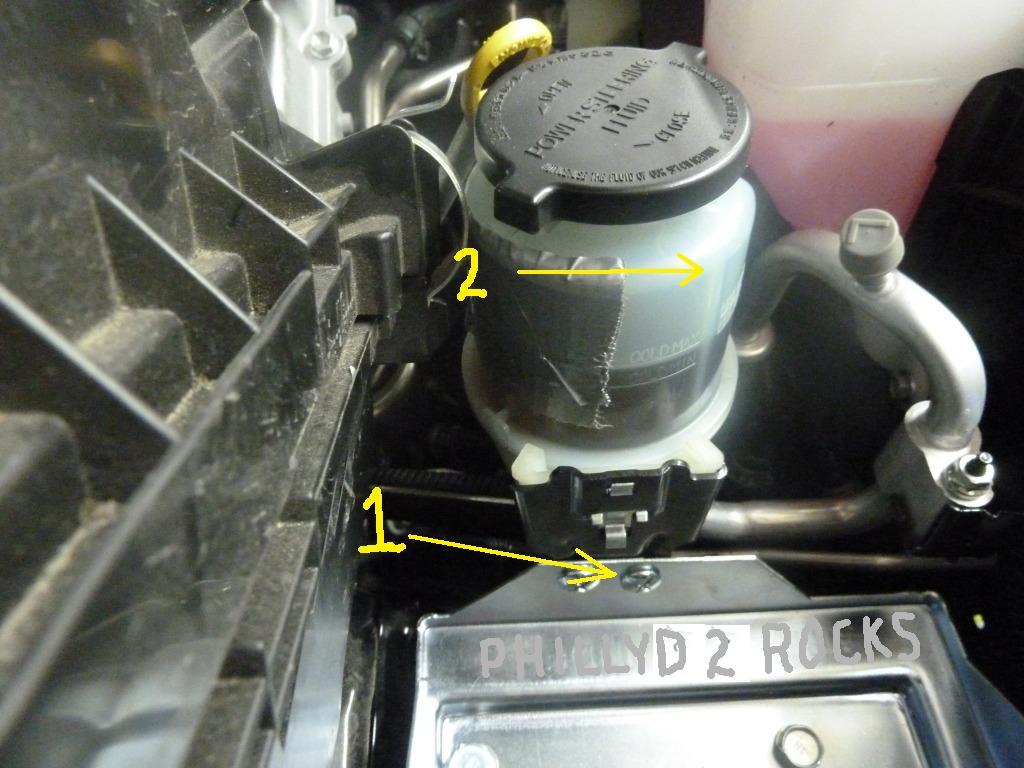

I see. All my play is towards the air filter. :ybrick: I put a piece of tape between the clip and reservoir to see how much rubbing and wear it gets over time. I may elongate the holes to give me more play.

Have not yet modified anything. Anybody think the constant rubbing of the clip against the reservoir will cause issues in the long run?

I would not leave it like that. Also check your pwr steering hose on the left in the pic. Mine was touching the metal dip stick bracket. I grabbed the hose clap with plyers and rotated the hose so it had clearance.
^^ I agree...dust tape is not a good choice...rubber type roofing would provide better rub protection.
that being said just enlarge (1) the hole a bit with a rat tail file, and spin the reservoir over an 1/8" or so (2)

Take the duct tape off and stick it to your head (for punishment ):whipping2... and slot the screw holes a little bit.
Ha Ha. Tape was just to see how much it rubbed during a drive. Since the truck ended up in a zillion pieces its has not moved since. Anyways, power stearing is for girls, right? :moon:
