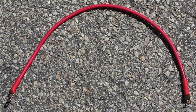

Yesterday decided to get a jump start on increasing wire size/gauge prior to alternator install (shipping in a couple of weeks fingers crossed)............added 2 of the "BIG 3" wiring mod. All grounding points were cleaned prior to assemble to insure proper grounding. Positive wire will be installed during alternator install, certainly will be easier once battery is removed.
4ga wire, soldered terminals, added heat shrink to prevent corrosion.

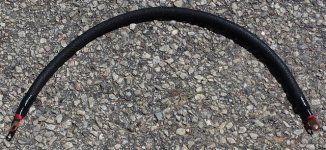

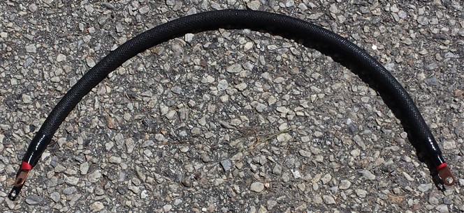

Added asphalt loom to positive wire to protect from exhaust heat and chaffing. Ground wires have standard split loom.

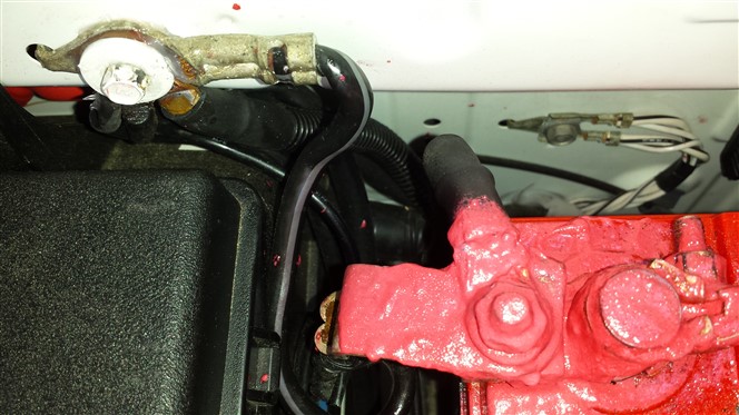

4ga ground wire from negative battery terminal to body with anti corrosion spray.

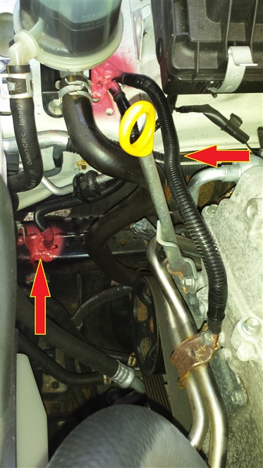

4ga ground wire from block to body & frame to body.
