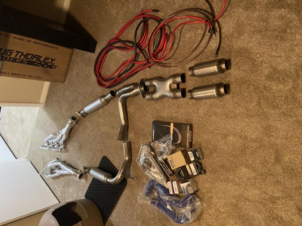

So it’s finally all here and in about 10 days I’ll be dropping my girl off for some much needed maintenance and full exhaust treatment.
Doing a complete timing belt kit, upgrading battery cables to 0ga and 4ga, new battery and terminals, and DG Headers/midpipe and customized to be a true dual with 7” race mufflers and x-pipe!!
I will have to cut the mid pipe and really looked at getting a custom one built but with parts and labor wasn’t saving enough to offset what I’m getting my guy to do all of this for.
Also went with stage 8 locking header bolts, all new O2 sensors with bypass for the rears, and silicone radiator hoses from HPS. All material is 304 stainless although I think one of the DG items might in fact be 409.
Looks good, going to be loud though!
I have 2 OEM cats, an x pipe, and 2 Magnaflow 18"x6" dia mufflers and its medium volume. I'd be interested to hear it if you want to post a quick video when its done.
Seriously. RIP to any conversation happening in that truck.
It’s gonna be a little in the obnoxious side I think but I’ll love it. I’ll definitely post some before and after pics and videos for the difference. Also forgot to add the SAI bypass coming in the mail today.
