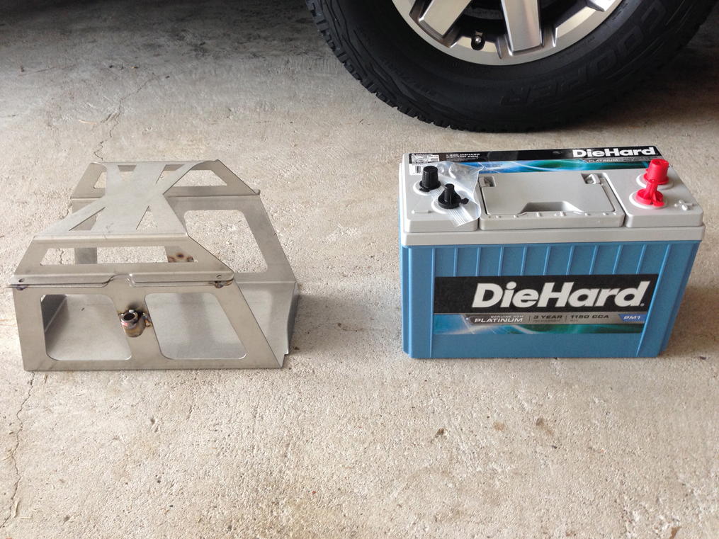

Just finished my group 31M battery install along with a new Pelfreybilt cage. I think it all went well other than being a heavy pita! I plastidipd the cage so has a nice low profile look and also used the Remy Battery screw on posts so the install looks factory and leaves the main posts for accessories. Despite the weight difference their is no noticeable lean or sag on the driver front.
:painkiller:

Nice looks good :) I plastic dipped too, so far so good. I have been out bouncing around a few times since I installed it and the thing has even moved a smidge, cage is solid.
LOL no doubt I had to use a short step ladder and a foot on the top of the fender for balance. Last thing I wanted to do was drop it on anything! You would f'k something up dropping it from 4 feet.:rip:

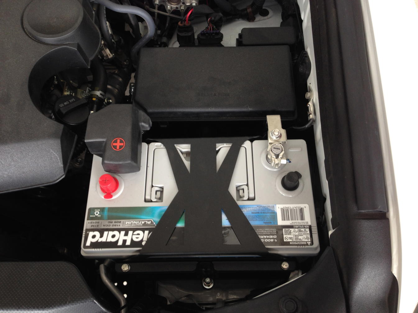

:painkiller:

A simple but useful question : After you install Remy Battery screw on posts, you DID NOT need to modify any the stock cable or connectors or terminals. This becomes a truely plug and play to swap out the battery ONLY? Is this a correct understanding after using those Remy screws?
Because the battery is larger, the posts sit in a different location. the problem is that the leads have L-shaped ends and getting those to fit over the edge of the battery is a challenge. For that reason, most of us bend them straight.
If you use the smaller terminal posts that sit a little closer to the edge, you may be in better luck, but once you start adding accessories, that what most of us use those for.
Getting some fleet terminals may also help, because they extend a little further from the post.

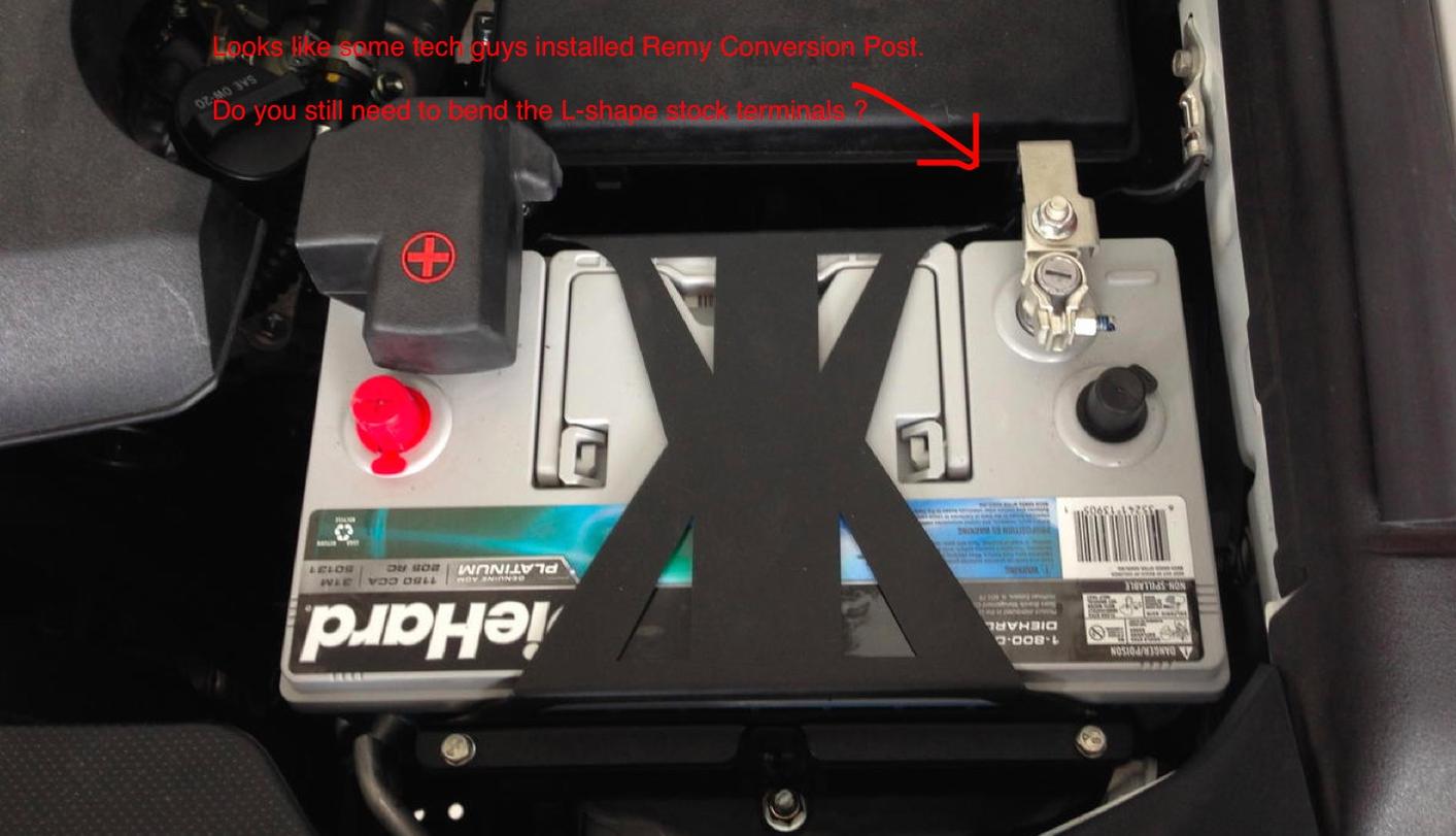

I am not sure if there is a need to bend the leads (L-shape). Should I buy both:
1. Remy (this is a must since I have to use the marine terminals that is more closer to the edge of the battery)
AND
2. Fleet terminals (this makes long extension of terminal connections so there it may not need to bend the L-shape leads).
But I look at some previous pictures, looks like the L-shape lead did not bend at all?? Anyone did not bend the L-shape lead and can install it with plug and play?
