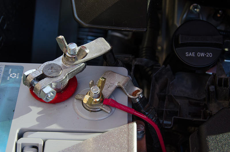

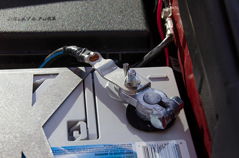

I wasn't going to post pictures till I had this more neatly done. But since several people may be dealing with this this weekend. This does work fine for long term, I just don't like that it's a little weird looking. These pics are for a 5th gen, of course other gens may be completely different :/
Negative terminal. Not too bad, but I did have to bend up the 90 degree angle in the tab to get it to clear the battery and the edge of the battery cage. Unfortunately it does cover the secondary negative terminal.
Positive terminal(s). Not clean. The starter cable would reach the clamp but the accessory cable would not, had to put that on the other terminal. I want to save the two secondary terminals for my additional accessories and use the main terminals just for the stock power (Well and a winch some day). No real reason, just neatness sake, and being able to unhook my accessories without removing power from the car electronics and resetting everything.

OK, mine looks like ass, but all I care about is that it functions safely. I had to bend the negative connector, and connected to a marine battery terminal. For some reason, the positive marine battery terminal post was too thick for the starter and accessory power lines. I had to bend both positive cables, included the little tabs on the accessory line. I ended up making the oem terminal work. Is there any danger in using the OEM terminal as opposed to the marine terminal (which admittedly is more heavy duty)?
Here are some pictures...
The finished job.
The positive terminal. Notice that I used the oem terminal. Is there any danger in that or should I switch to the heavier duty marine terminal?
The negative connection.
Nope, you'll be fine. The stock terminal is sized appropriately for all the factory loads that should be coming through that point. If you start adding more high amperage accessories like an air compressor or winch you could consider swapping the terminal for something heavier.
