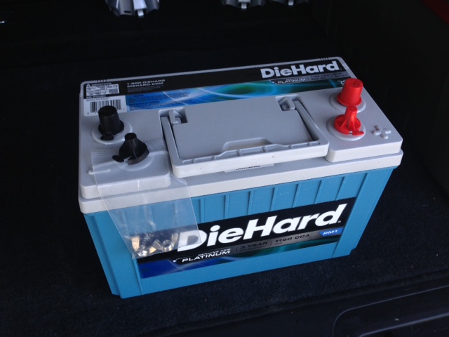

$220.31 out the door (guy was kind enough to waive the core too :) ) only two left in northern Utah! The 5th is the last day these are on sale. Thing is a beast! LOL my rear suspension sank when I tossed it in the back
