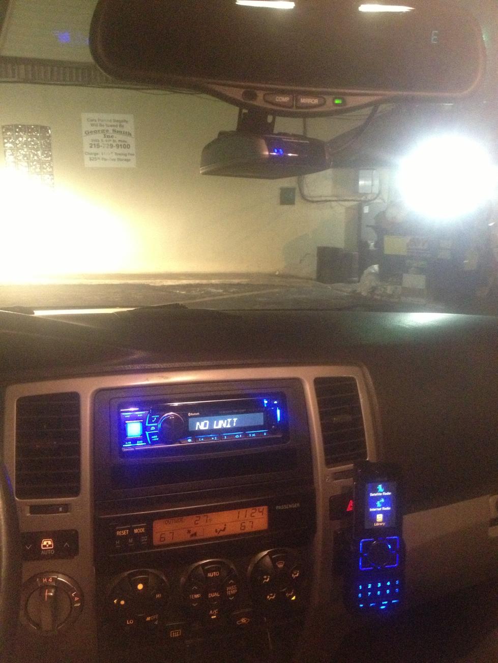

My rig is an '03 limited with the JBL. I am MUCH happier with the new HU as opposed to the aux cable - Make sure you also get a HU that's sirius ready if you want to keep the sirius.
The new HU gets way louder and the sound is much better.
my setup
Heres my radio
That's great... thanks. What adapter did you use to keep OEM sub?
Metra TYTO-01 (60 on amazon, don't pay a cent more, the local best buy charged like 110)
Metra steering wheel controls (40 on amazon)
My stupid HU didn't have 4 RCA ports so I had to use a line output converter to get rear audio. Spend a bit extra on the HU for the RCA ports...
I really didn't want a double DIN because I wanted the storage pocket.
Also, that's a sirius stiletto thing on the side.
Also, since the amp is digital,. you have to equalize all the control with the factory stereo before removing it... i learned this the hard way lol
