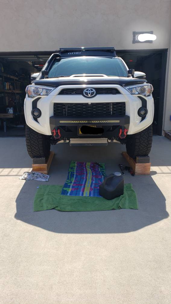

Just changed mine last week with OEM filter and o-ring (2019). Never the slightest hint of any oil leakage around the metal housing. 20210903_184747.jpg
Sent from my SM-N960U using Tapatalk
