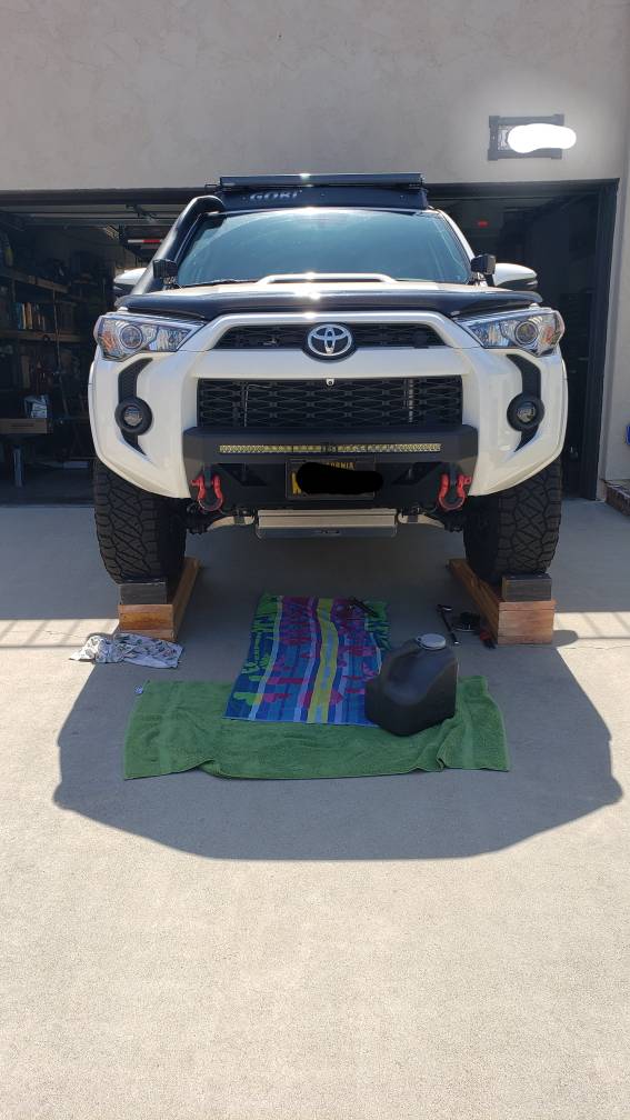

Are those homemade wooden ramps? I want those.
That's an excellent ramp design for tires wider than stock. My handmade ramps are narrower for a stock tire size. Make yourself a pair. You'll find they are solid and stable. Mine have a ramp run-to-rise ratio of 16 to 5.5 inches which is easy to drive onto in 4Lo. The overall length of my ramp is 25 inches (flat) + 16 inches (ramp). The flat portion ends up being 21.5 inches long with a 3.5 x 3.5 stop block installed. His ramps appear to be a little higher than mine. 5.5 inches is the minimum height one needs to be able to remove a stock skid plate if the outer 1/4 inch of the J hooks are bent back from 90 to 45 degrees.
I’ve been thinking about making some for too long.
I want four of them.

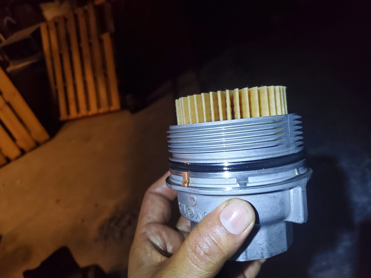

This image shows proper location for the o-ring

There has to be a defect in one of the mating surfaces like a scratch, or a defect in the orings or possibly porosity in the aluminum of either.

Had me look at it and found he was not putting the oring in the groove but had it against the flange.
