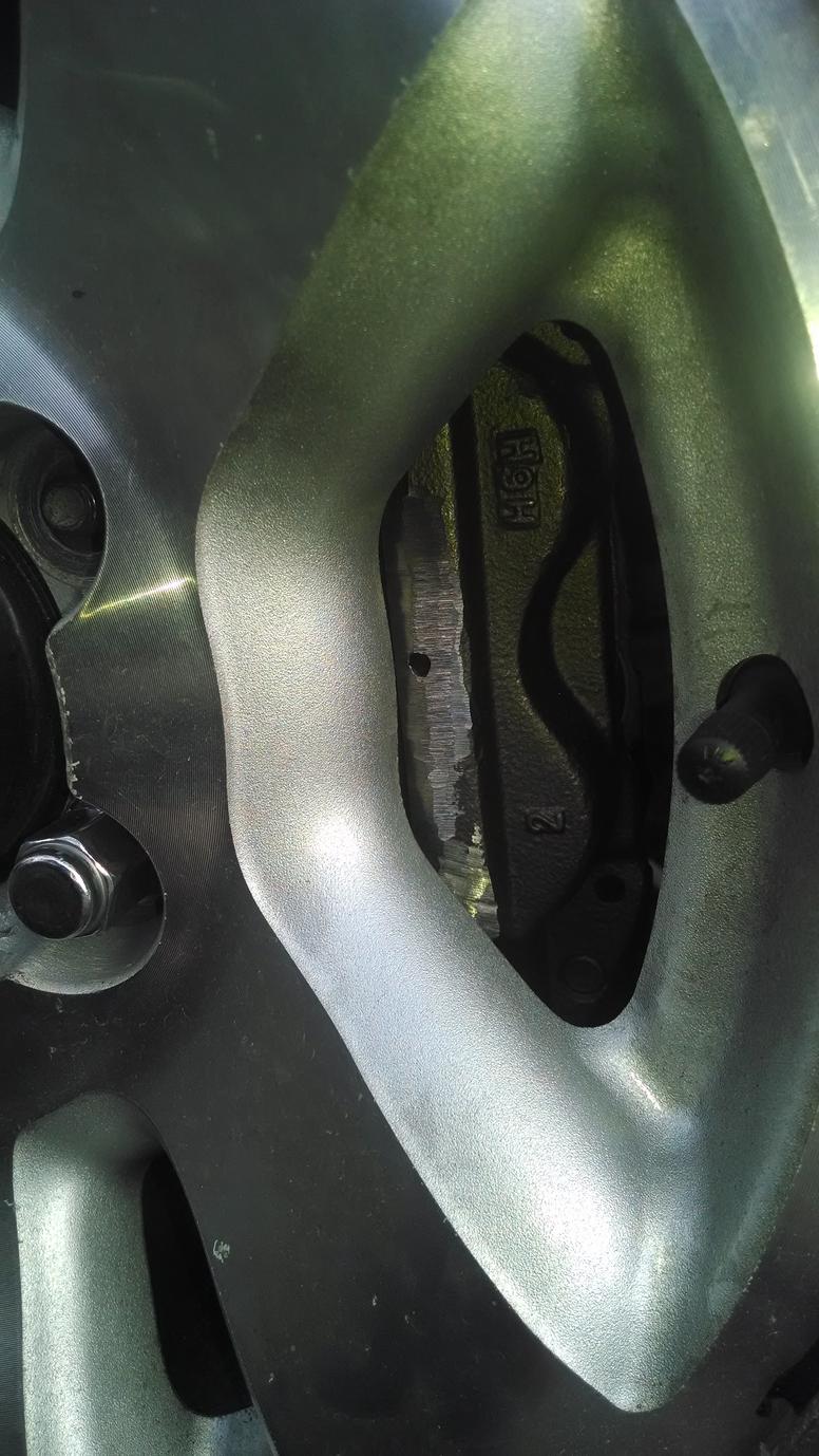

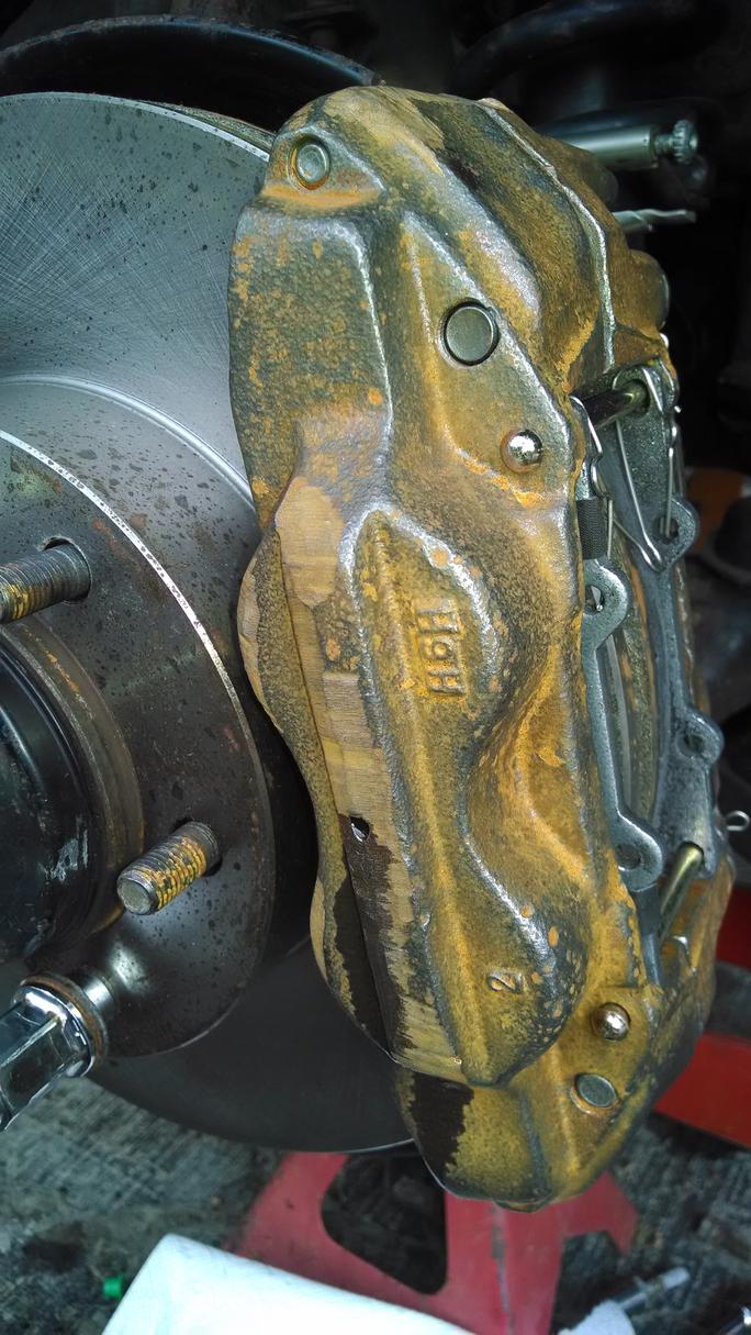

Tried the grinding on caliper idea... uncovered a hole that appears to be a reservoir as it terminated where I ground and was the only place left besides the top/bottom of the caliper that was just a hair too close to the split 3 spoke wheels... I'm thinking I will throw a dab of JB weld in there and close it up... That seems fairly risky but jb weld is pretty solid. Or I start over with a $75 caliper and go the extra money for spacers and new lug studs... who wants to weigh in?
there is no way in hell I would trust jb weld for that use. You die when you need to stop but you can't.
That's the one thing I wouldn't skimp out on. Brakes are the only thing that keep you alive when you need to stop. Better to pay extra now for peace of mind later.
