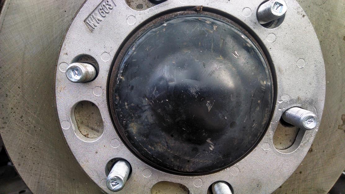

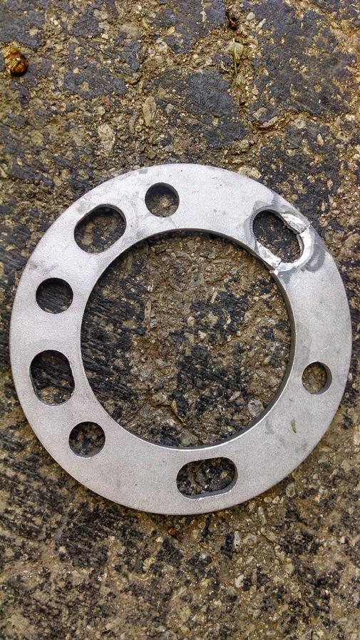

First I used the lug nuts and tightened them to the hub to try and pull the studs through. This caused the nuts to get mangled on the tapered side facing the hub (hub is harder).... next I figured the rotor and wheel being on would stop the shaking of the hub after nuts tightened from the impact wrench (which with me holding hub was just softening the blows). Also figured the wheels being on would kept the nuts from getting mangled... (fyi, didn't use spacers, just offset wheels so they didn't hit caliper too much... studs not being flush didn't allow for spacer to be installed yet)... This was when I started sheering studs.. lol Sooo, next idea was just to use both spacers and allow lug nut to seat into the wide slot to pull against the studs.... It basically worked but all the continued impacting shows it's wear.... the spacer still seems usable though :-) It got alot easier once I grinded down the studs a little.... hope this helps anybody going that route...
my spacers from autozone were not snug to the hub and while I'm sure it's been mentioned somewhere, I kind of figured this could lead to things being unbalanced.... so after I got wheel on (not too snug), I used a flat headed screwdriver at the top of the spacer through the centercap hole to give it that 1/16" of space on the top and basically all the way around... maybe that is overkill but seems logical... In the pic I stuck a tiny twig at the top just to get an idea of the spacing around the hub for the spacer.
