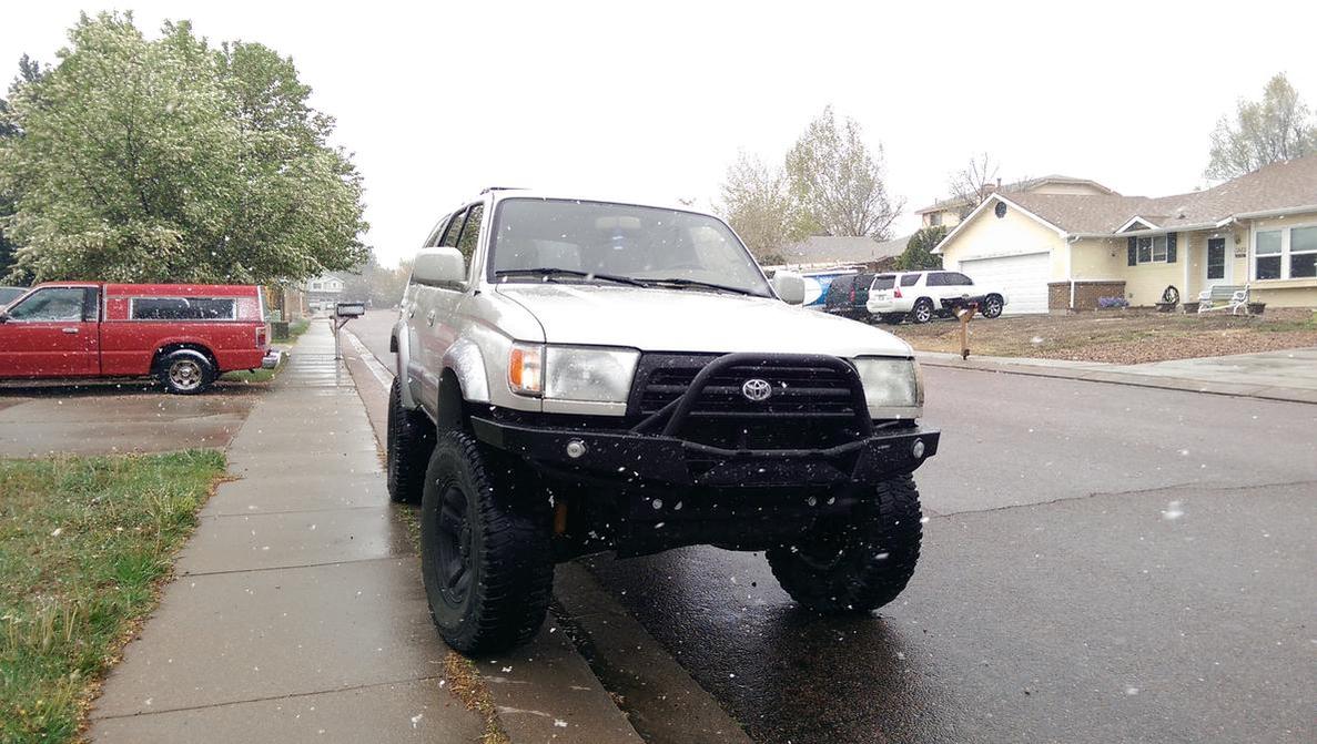

It does make it look a bit bigger, but not in a bad way. The good thing about not running rear spacers is that if you do flex her out the tires dont get hung up on the outside of the fender. I dont have a direct shot but this is how it looks. As you can see the front does look a bit wider. But SAS trucks look the same way, just makes it look tough IMO.

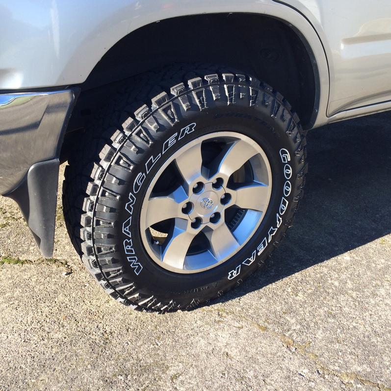

I realize this is probably a dumb question....but I am going to be doing this upgrade soon with the 5-star OEM wheels....
I plan on buying a 5th wheel to replace my spare and not have to deal with any front to back rotation in the event of a flat.
Question is will the 5star OEM fit underneath the car the same way as the factory spare does?

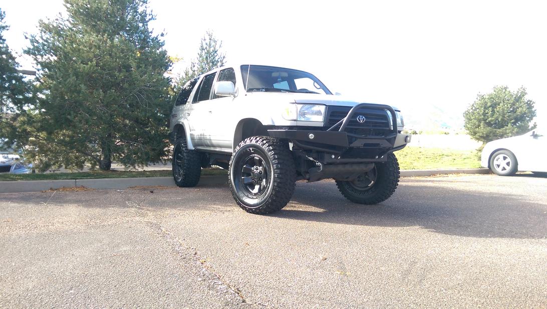

I did this conversion on my 99 SR5 and used a set of 2011 17x7 4Runner wheels as they had the same back spacing as the 1999 wheels so there was plenty of upper A arm clearance for the tires. See my album for pics
Procomp 7069 with 4 inch backspacing fits perfectly. Plenty of room for the brakes and a-arms.
This is with 285-75-16 tires.
Note I do have Total Chaos UCAs so that might make a slight difference, but I think the factory ones would fit just fine too...
