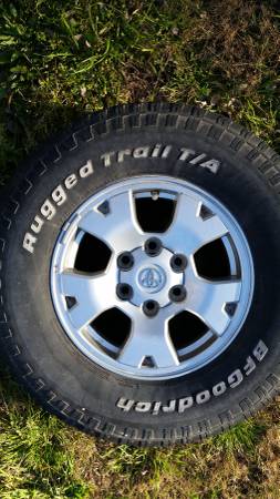

Can someone confirm if they will work with the 231's. I'm not sure the name of these wheels. I believe they can on some FJ cruisers and 3rd/4th T4R's.
BFAD mentioned some 5 spoke FJ wheels that fit with spacers on page 1 but I wasn't sure if those were these. I went to the reference link he provided and it was just mentioned there with no picture confirmation so I couldn't tell if they were indeed my wheels.

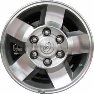

Sadly, not seeing my wheels on the approved list for 231mm.... see pic. Anyone know if they fit? Thanks

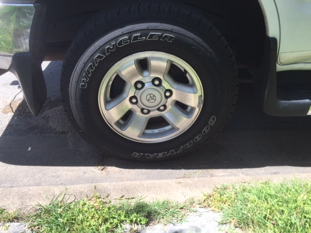

how about these Tacaoma wheels?
Found these on CL. I would upgrade from my 15". It looks like they would work for the 231mm just confirming. Would they
A. Fit my 2001 4runner?
B. Work without mods for the 231mm upgrade?

I believe those are 16" so they should fit. Might need to still trim the rotors just a bit though.

Just to clarify, this is not accurate. 5 Star wheels clear the tundra brakes, no grinding required. I have both. The 5 stars I am referring to are shown below. (thanks to Brilliant for the picture I borrowed; his picture is photo-shopped but that is not relevant to this conversation.)
And you mean 16" right?
Let me rephrase that... I justu want to confirm that NO 15" factory wheels will work without grinding or spacers for the 231mm...
eg OEM 4-Runner "5-Star" wheels PIC

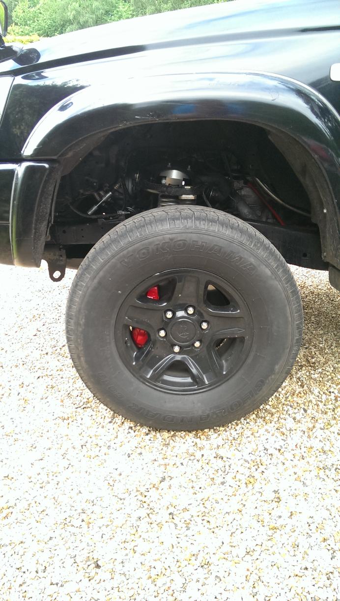

OEM 16" 5 stars (actually these are off a landcruiser Colorado.. but meh, same wheel) definitely fit over the 231mm callipers.
It's tight as hell, but they do go on and they do turn. I don't use spacers. An unfortunately placed balancing weight would catch though.

These fit too and look way more awesomererer. :cheer2:
