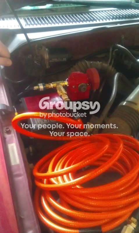

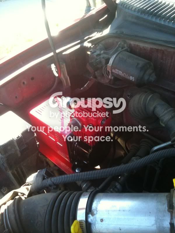

I added a ARB CKMA12 onboard compressor for my front locker and can also use it for filling up. I mounted it next to the battery by bolting down a plate of metal from home depot under the battery that exceeds into the empty space. Then used an 'L' bracket under it for support. Lastly, mounted the compressor to it. I painted the plate to reduce rust as well.
3618d0b1.jpg~original
bb23916e.jpg~original
7631b756.jpg~original
I'd love to add a tank down the line but right now my funds are going elsewhere. It fills up to a 35" tire so it works for me.

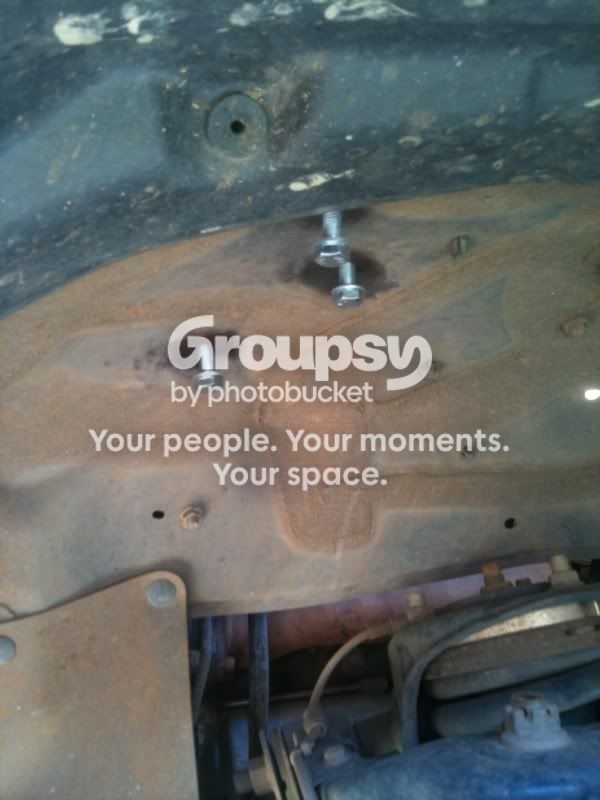

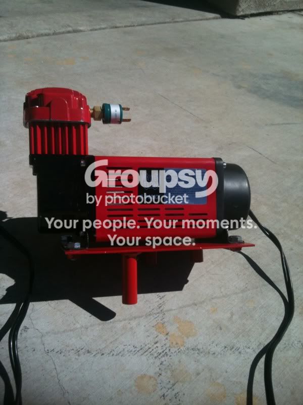

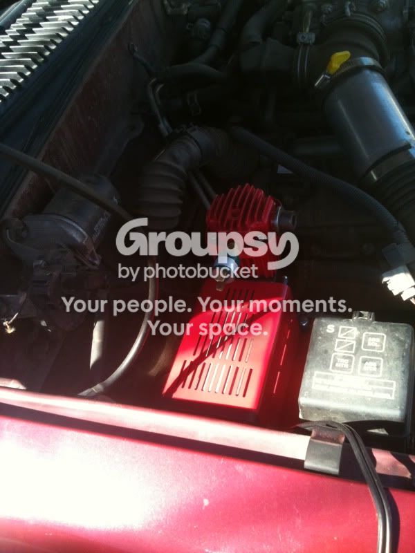

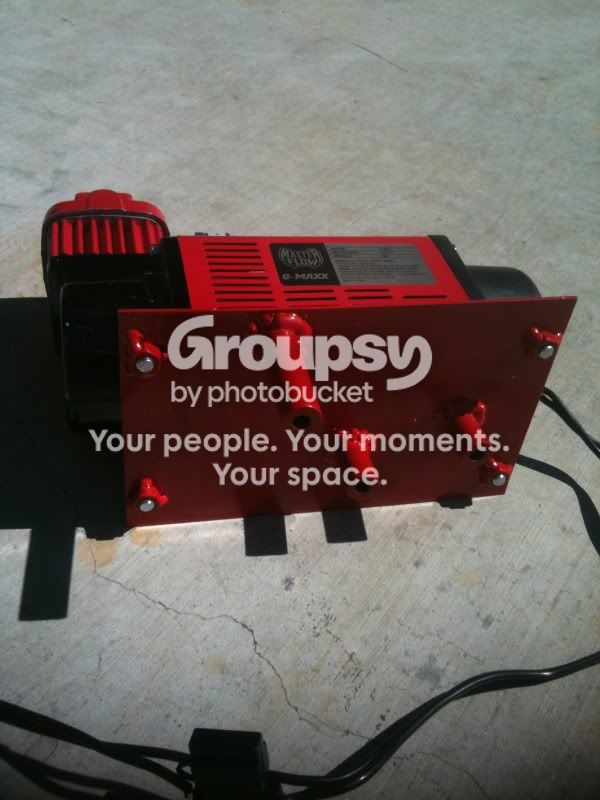

heres my $50 Q industries compessor i hard mounted.
The mount
photo1.jpg~original
photo2.jpg~original
in place
photo3.jpg~original
photo4.jpg~original
where it bolts to(not installed yet, gotta figure out the wiring first.)
photo5.jpg~original
all done

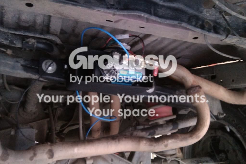

i went with a ARB compressor for on-board air, mainly for my air locker though. here is how and where i mounted my compressor, the fresh-air intake is inside the cabin in the back cargo area of the 4runner, so even if i submerge the compressor under water(and i have) it will still pull the air thats in the passenger compartment -and its cleaner air than what would be outside too

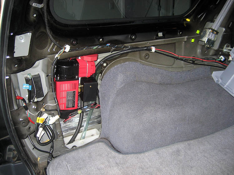

My concern with mounting the compressor in the engine bay is that it is a hot location and will make it so the heat protection on the compressor kicks in sooner. Mounting the compressor under the truck exposes it to damage from dirt and water. Mounting it in the truck is great for temperature and keeping it safe, but then you have to hear the compressor when it is running. That said, I mounted mine in the rear behind a trim panel.

did you see the giant steel housing i put mine in, just for that reason. and dirt and other debris is not of any real concern, as long as it pulls clean air it will work, even submerged in mud... and its easy enough to get under their and wash it off with a hose.
Here's a writeup.

Now that is exactly what I'm looking for; I love that mounting location. Do you have any issues with the compressor rattling around or overheating with it tucked away behind the trim panel?
I mounted the compressor on some rubber isolators and have had no issue with rattling. When I first posted pictures of the setup quite a few people expressed concerns that it would overheat, but it's been there for 2+ years and has been used on many trips and I've had no issues.
