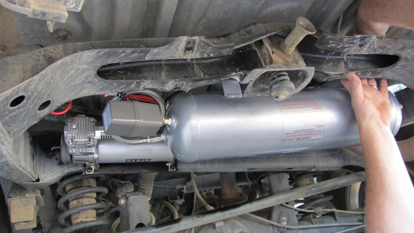

i have had water over my mirrors and never had an issue with my locker or compressor. i simply ran a 1/2" id hose from inside the back trim panel(up at the roof line) down to a barbed fitting and used that to replace ARBs filter/intake. it has worked fine and on a scale of 1-10 for engine noise, its a 2-3, i have to have the radio off and sitting still to hear it. i have had it down there for over a year, never once has it had contact with anything or failed to work or miss a beat. as far as over heating goes, well it get all the fresh air it could ever want
tacojeff - I've seen setups where the tank was separated and bolted to the undercarriage. I think that's what I'll do.
Just a question for those running with this mounting location any over heating at all? on a scale of 1 to 10, 10 being as loud as the engine 1 being silent, how would you rate the noise level inside the cab?
I chose to mout my Viair 400C compressor in the same location as slomatt, behind the rear panel on the drivers side.
As far as the noise level goes, I would say that it is between a 7 and 8 with all the doors closed. However, right now I only use my compressor for airing up my tires so I alway have the trunk open when I'm using it so I don't have to worry about the noise.
Just assuming that's an old pic you do have the panel covering it now right? I would imagine that when im using it for airing up I wouldnt be in the vehicle anyway and when i switch it on to run the lockers it's going to charge the system then shut off so it shouldn't be to much of a bother to hear it in the cab.
I'm probably going to go this route If the 4th gen panel allocates enough space in the same fender area.
If not I'll likely build a cargo box and incorporate the compressor inside an enclosure with an access panel, I can probably line the box with some dyno matt or similar insulation to reduce noise and perhaps extend the intake breathers to the outside of the box. Thanks for all the input an perspectives on the install I'm fairly certain I've got the info i need to go ahead with the install. just gotta round up some extra fittings to run the air line outside the vehicle for quick access to airing up tires. and some time to get it all tide up an neat looking.
