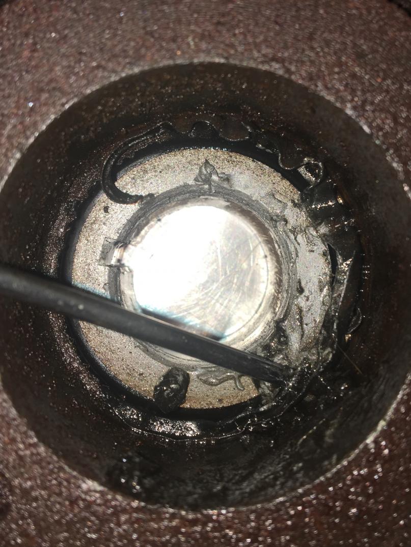

Removed the crankshaft pulley/harmonic balancer today using a wheel puller and M8x125 bolts threaded through the pulley. Unit came off under steady strain. No scoring on the crankshaft or damage to key. Prior to removal noticed rubber material extruding around the periphery of the balancer bore. Engine has 451K on it. Appreciate any feedback or opinions as to if the balancer is damaged and needs to be replaced. Crankshaft bolt was definitely at torque spec given difficulty breaking loose and removing.

that is really strange
did somebody use Toyota FIP thinking they were sealing it onto the crank?
451K is a lot of miles how long have you owned it? kind of seems like a unique service was performed?
I ended up replacing my original crank pulley because somebody had chipped the outside groves, the inside of mine was still fine but it was starting to eat belts. that one looks kind of damaged to me, I guess the risk is you might gouge the crank putting it back on? That engine has made a long ways and replacing a crank is a big job. would be a shame to end it's service by messing up the crank.
I agree with [MENTION=168172]sleepydad[/MENTION], what kind of weird crap has someone being doing to that balancer? Just get another one.

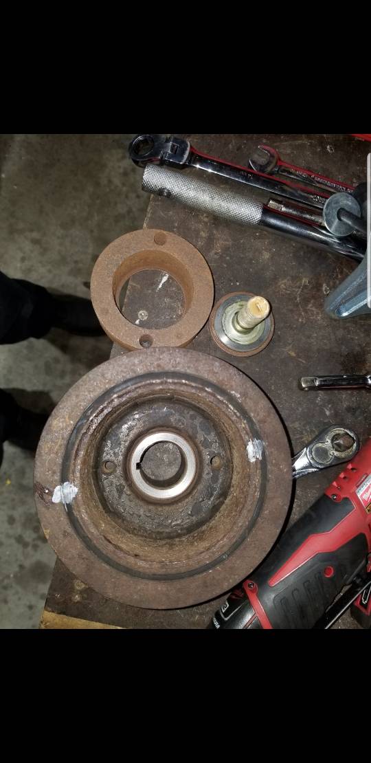

There is a inner metal "doughnut" that is somehow attached to the harmonic balancer. My original HB had this metal doughnut randomly fall off.
I could not figure out how it was attached to the HB, maybe they are spot welded in place?
I drove my truck for a couple years with that inner metal doughtnut sitting on my bench and it didn't seem to screw anything up. But, they wouldn't put that thing on there for no reason, I'm sure there are some engineering reasons for it.
My 99 donor engine had a aluminum aftermarket HB installed on it and it did not have that metal ring on it at all.
Perhaps your HB had that same ring fall off and someone tried gluing it back in place??
Either way, I would install a new HB.
Pic of the inner ring that fell off. Maybe yours fell off too and someone tried FIPGing it back in place?

Back to the OP's question, if that inner metal ring was "glued" back in place, I would replace that HB as soon as possible.
When the OEM HB is manufactured, I'm sure they center that ring as dead on as possible otherwise the HB will not be balanced. You do not want the HB to be unbalanced!
This is why I just left it off, I figured it would be better to not be on there than me trying to somehow "glue" it back in place and throwing off the balance.
Get yourself a new HB and call it a day. If your timing belt/WP is due soon, now would be the time to do it.
Good luck!
Thanks for the advice (also [MENTION=10169]TheDurk[/MENTION] [MENTION=138943]thegipper[/MENTION], and [MENTION=135331]msh03046[/MENTION]). Wasn't planning on replacing as part of the rebuild; but will replace it now. Uncanny that there would be adhesive holding the balancer together. I was torquing on that inner ring with the OTC pulley tool when removing the crank bolt. Appreciate the vendors for the aftermarket balancers. I'm going that route; especially from a weight saving/supercharger perspective.
I doubt they "glue" that inner ring on from the factory, my guess is it is spot welded. Again, my theory is yours fell off like mine and someone tried gluing it back in place which was a bad idea.
