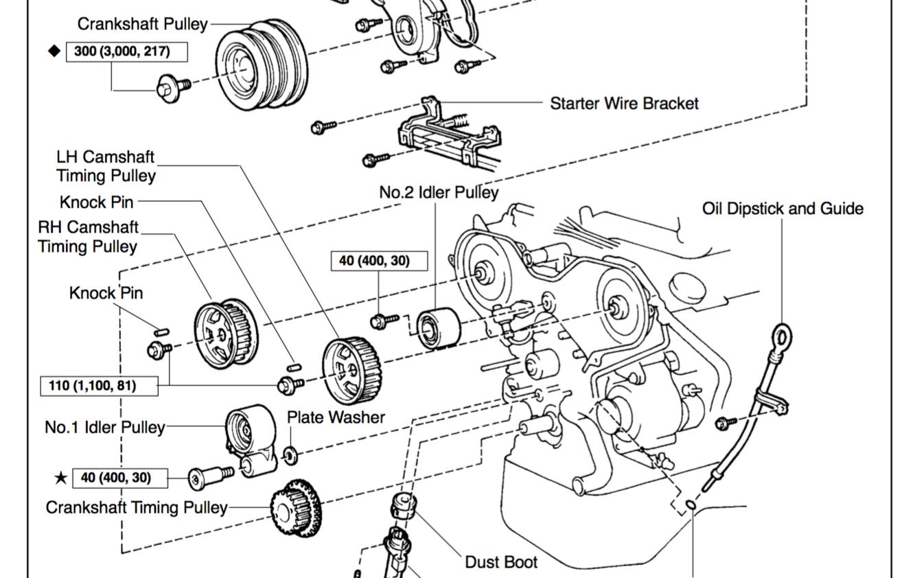

Chris (DavisTN), Does your fix remain successful? How difficult was it to replace the idler pulley, and which one was it - the SM has more than one idler pulley - ? I've attached a screenshot of the SM for reference.

I may not have called it by the correct name. It was the bearing on the serpentine belt tensioner that was creating some chatter. That vibration is resolved.
