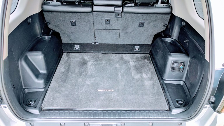

I have a '15 Limited, hoping to swap parts if anyone wants to unload their rear sliding cargo tray/deck. Happy to help remove it. Located in eastern PA west of Philly, willing to drive a few hours if necessary. I will also post in the FS/FT section. Thanks.
