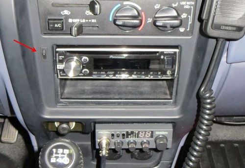

That's how I do when I go wheelin. Down antenna listen to USB. If I remember blue or amp power wire, then wire switch in series.

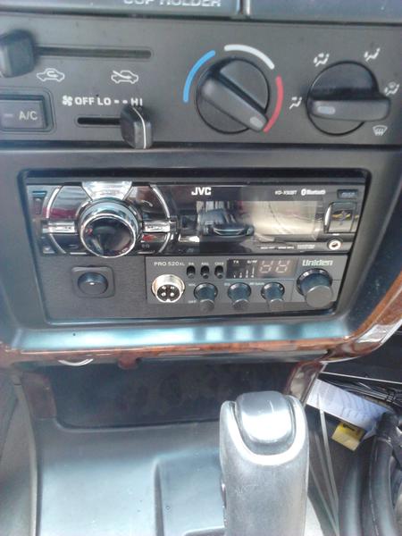

This is my solution. Looks like it is supposed to be there. Got the switch on amazon.

I went same as most the others here.. Got a simple toggle switch and wired to my aftermarket headunits' power antenna lead.
Put the switch down below in the open gap near the cig lighters.
Works great and doesn't appear too "out of the norm" with the rest of the console in my opinion.
