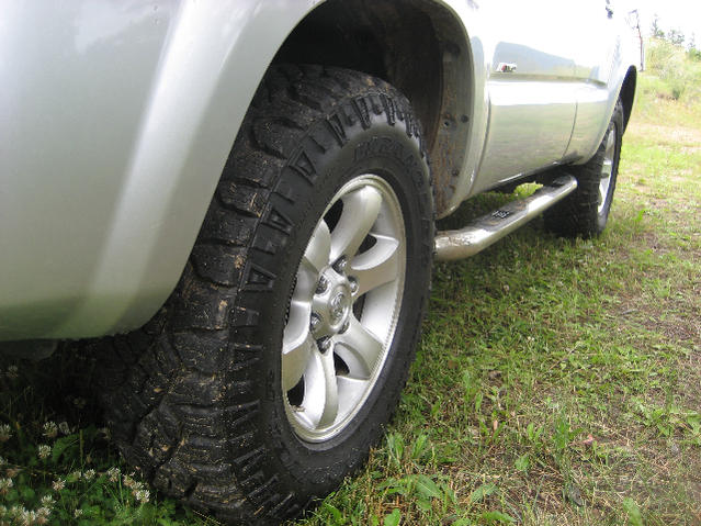

Duratrac! you will love them! I searched for over a month for reviews on all types of AT's. I got lots of people telling me to run Revo's,GY Silent Armor, Toyo Open country/ Nitto TG or BFG. But I had already had the BFG AT and wasn't too impressed.... and the other tires didn't give me the look I was after (MT style but AT drivability) So I chose the GY Duratrac. After they were installed I knew I made the right choice! I get comments on them all the time. Go see them in person you will love them!
thanks those are definitley on the top of my list for next tires because they are under 200 each and will give me that mud terrain look with all terrain driveability as u said. what size are yours because i wanted to go 285/75/16 for my next set with my 3 inch lift
