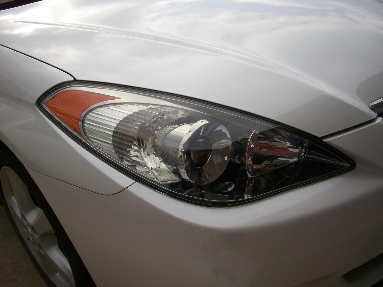

I manage a body shop in north Georgia & my observation is that this happens to all makes & models. We run into issues with this most when someone has a collision with say the right front & we replace that headlamp which then of course makes the left front headlamp look just that much worse. A word of warning, the polishing kits remove the hazing "clear coat" which looks good for a while but then allows the lens to yellow in the sun faster. The clear coat helps to protect the clear plastic lens (not well obviously) but when it's removed by those polishing kits they yellow and dull within a year after (depending on the environment). We have started offering a service where we sand all the clear coat off to get back to the nice clear plastic lens and then put a few coats of our automotive clear on the lens which works very well as long as the lens isn't too far gone. I have had to do this on everything from your average Corolla to the Mercedes E55 AMG so everyone is having this issue. I do believe that waxing the lens can help but eventually they will all do it. Before we purchased our '11 LE my wife had a '06 Solara that we owned since new, I waxed those lenses every time I waxed the car which was around 4 times per year & in 2010 I had to sand & clear them due to fade/yellowing. Here is a photo of one of the lamps on the Solara that I just took today & after going on 2+ years they still look good. Like I said, just my observations 100_6328.jpg

A word of warning, the polishing kits remove the hazing "clear coat" which looks good for a while but then allows the lens to yellow in the sun faster. The clear coat helps to protect the clear plastic lens (not well obviously) but when it's removed by those polishing kits they yellow and dull within a year after (depending on the environment). View attachment 82975
That's great to know... If you do use a kit do you recommend a particular clear coat?
I know that there are some headlamp restoration kits that come with a aerosol can of clear coat but that's not what we use. We are using the same clear coat that goes over the body of the vehicle. I have a few sublet vendors (paintless dent repair "lot" guys) that use the aerosol kits for on site h/l restoration but I don't think that product does as good of a job IMO. By the way I'm not trying to sell a service here, I'm just putting some info out here. I will ask for a brand name of the aerosol product they use next time they come in just to let everyone who is interested know.
After my daughter had an accident with her 03 Maxima and they replaced only one headlight, my body guy used Nu Finish scratch remover to clean the dull headlight and I just use it one or twice a moth with a rag and it clears it right up again?
