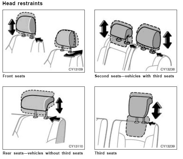

Mine doesn't really tilt, but it pivots, almost as if the headrests rotate along an axis near the top. When adjusted the back of the headrests can be near vertical or be slanted forward (bottom of the headrest sticks out towards the rear seats).
Right, I'm off to try manhandling mine into a better position... last time I tried, however, it didn't budge an inch. Perhaps the Limited has better headrests than the SE?
This is from the 2006 Owners Manual. It appears to apply to all models, so all of the front headrests should pivot as described above. I don't know which model year this started in.
OK, mine pivot but it turns out that the furthest forward they pivot is still not far enough for me. Guess I'll fiddle around with the seat position a bit more.
