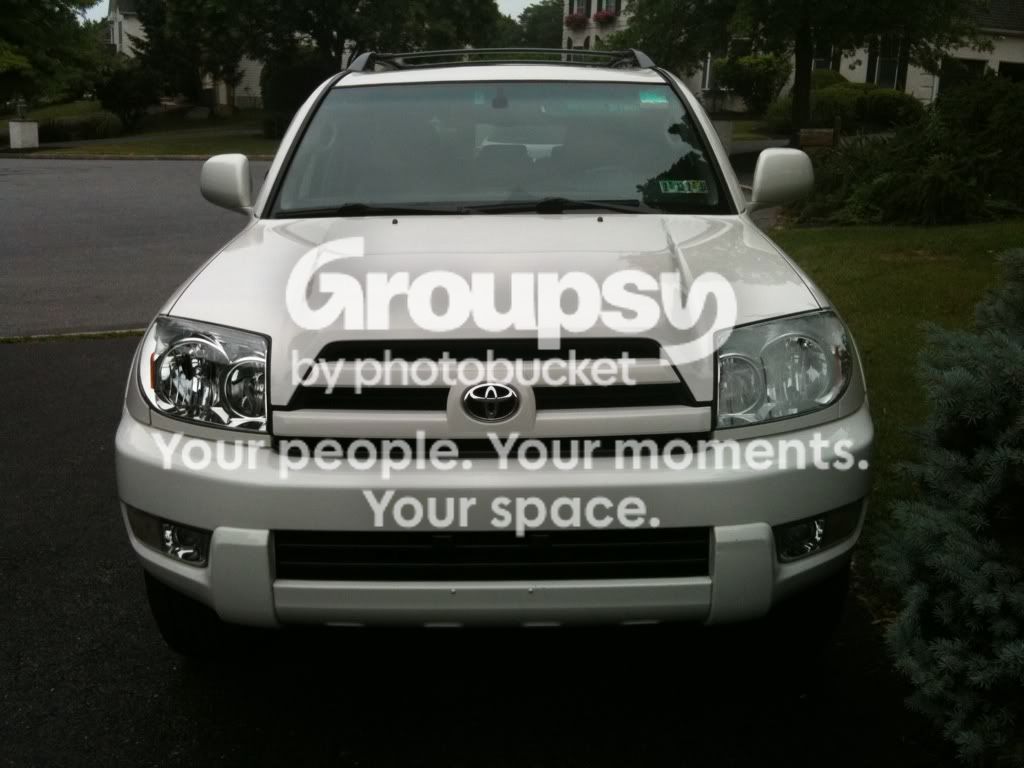

Your original lights being hazy is normal I suppose (age). Replacing them with fleabay ones? Were they used? Aftermarket? I purchased aftermarket headlights a while back and at the first car wash, they fogged up big time. I didn't care b/c they were installed temporarily. Anyway, the leak was from a poor seal at the bottom of the lens. Contact the vender.
In this pic, at first lots of condensation,then fog. Eventually they cleared up.

Mine looks exactly like your picture. I am going to have to take them off and find the leak and seal it..
