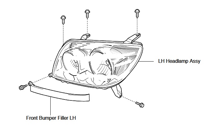

Its the same as on an 06-09. Im in the middle of blacking out my headlights as we speak and I just used those steps for my 03. Its just 4 bolts and three connectors unless you just remove the bulbs and leave them connected like I did.
Hope this helps
Perfect. Now to find where the seal failed. I read it could be the lamp base gasket but I am never that lucky.
