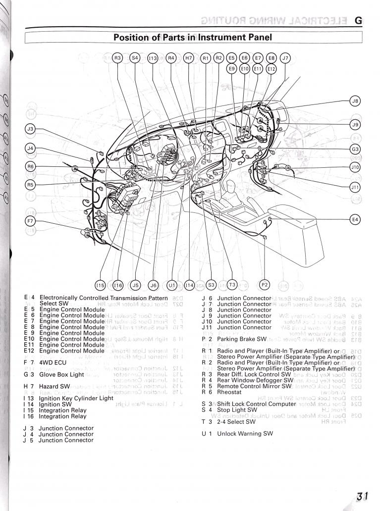

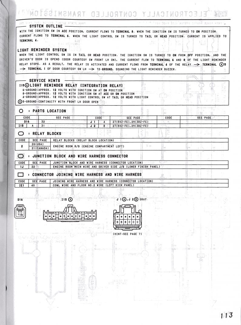

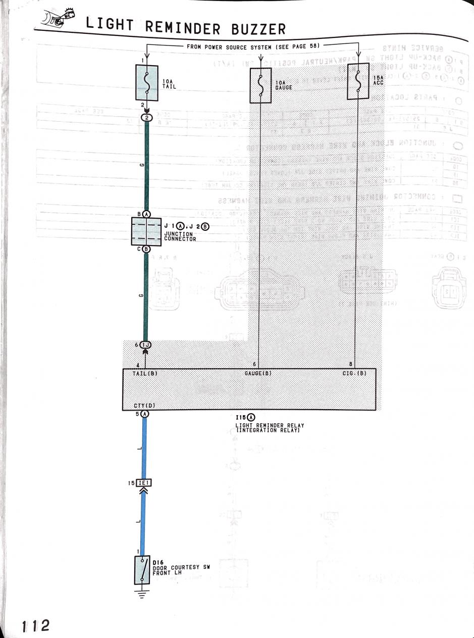

It shows a light reminder relay below and to the left of the steering column in the 1997 wiring diagram. Hopefully its the same or close for a 1996. I'll try to upload the outline and schematic in a few.
Hope this works and helps. It's called I15 Integration Relay on page 31.
