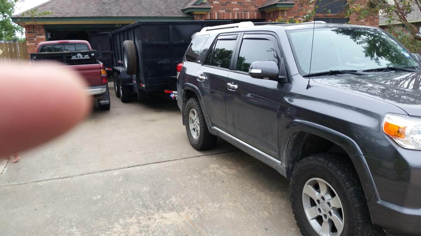

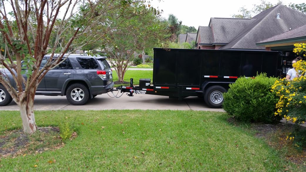

So I needed to pick up a pallet full of flooring about an hour from my house. My brother said I could borrow his new trailer and dropped it off when I was not home....it was much bigger and heavy duty than I thought....
On they way there it got 12.5 MPG on the way back it averaged 9.5 MPG!!!!!
The pallet I picked up was just over 2000 lbs...I called the trailer manufacturer and they said trailer was 2900 lbs so I was right at the 4runner limit...

Well I have some new info......just went to manufacturers website and it says the empty trailer is actually 3900 lbs!!!! Person on phone must have misunderstood me
That means I was pulling close to 6300 lbs.....
Is the towing limit a safety issue or is there some special maintenance I should perform now?
I will not be using that trailer again.....can't believe it weighs that much
Now the single digits make sense
How fast were you towing the garage door sized front wall on the trailer? Completely ignoring the weight behind that wall?

Yeah, exceeding the weight rating of the 4runner is a safety issue. And in Texas, you have to have trailer brakes for trailers over 4,500 lbs (gross (loaded) weight). If the brakes are electric, you need a brake controller in the tow vehicle to make them work. If they are hydraulic surge brakes (most Uhaul trailers), it's built into the coupler on the front of the trailer.
In many states the requirement is for brakes is for trailers over 3000lbs.
At low speeds it's OK (but still not legal) to exceed the weight rating of the tow vehicle. And on private property you can do whatever you want.
Next time maybe borrow your brothers truck? After seeing a trailer that big i would have swapped vehicles for a day.
