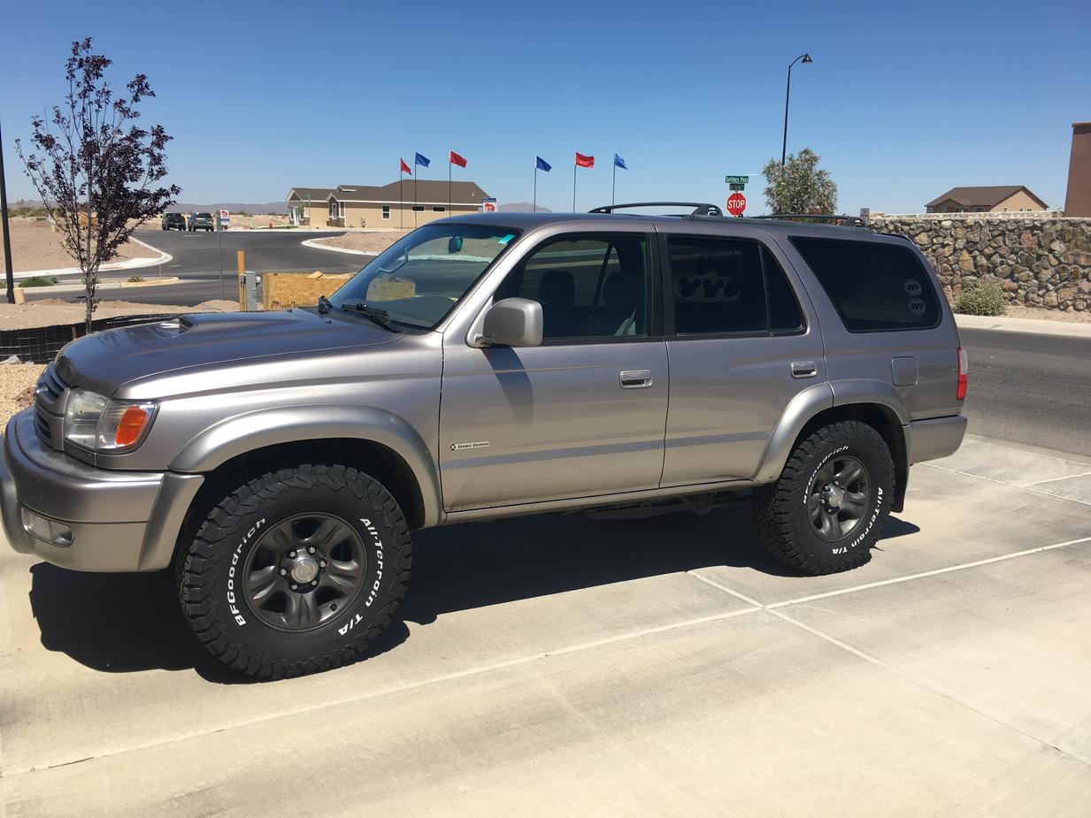

2002 Sport Edition
2002 Sport Edition 201,000 miles. With BFG KO2s 265/75/16, full tank of gas.
Driver side front: hub-fender: 19" Ground-Fender: 34"
Passenger side front: hub-fender: 19 1/4" Ground-Fender: 34 1/4"
Driver side rear: hub-fender: 19 1/2" Ground-Fender: 34 1/2"
Passenger side front: hub-fender: 19 1/2" Ground-Fender: 34 1/2"
Way too low need a lift stat!
