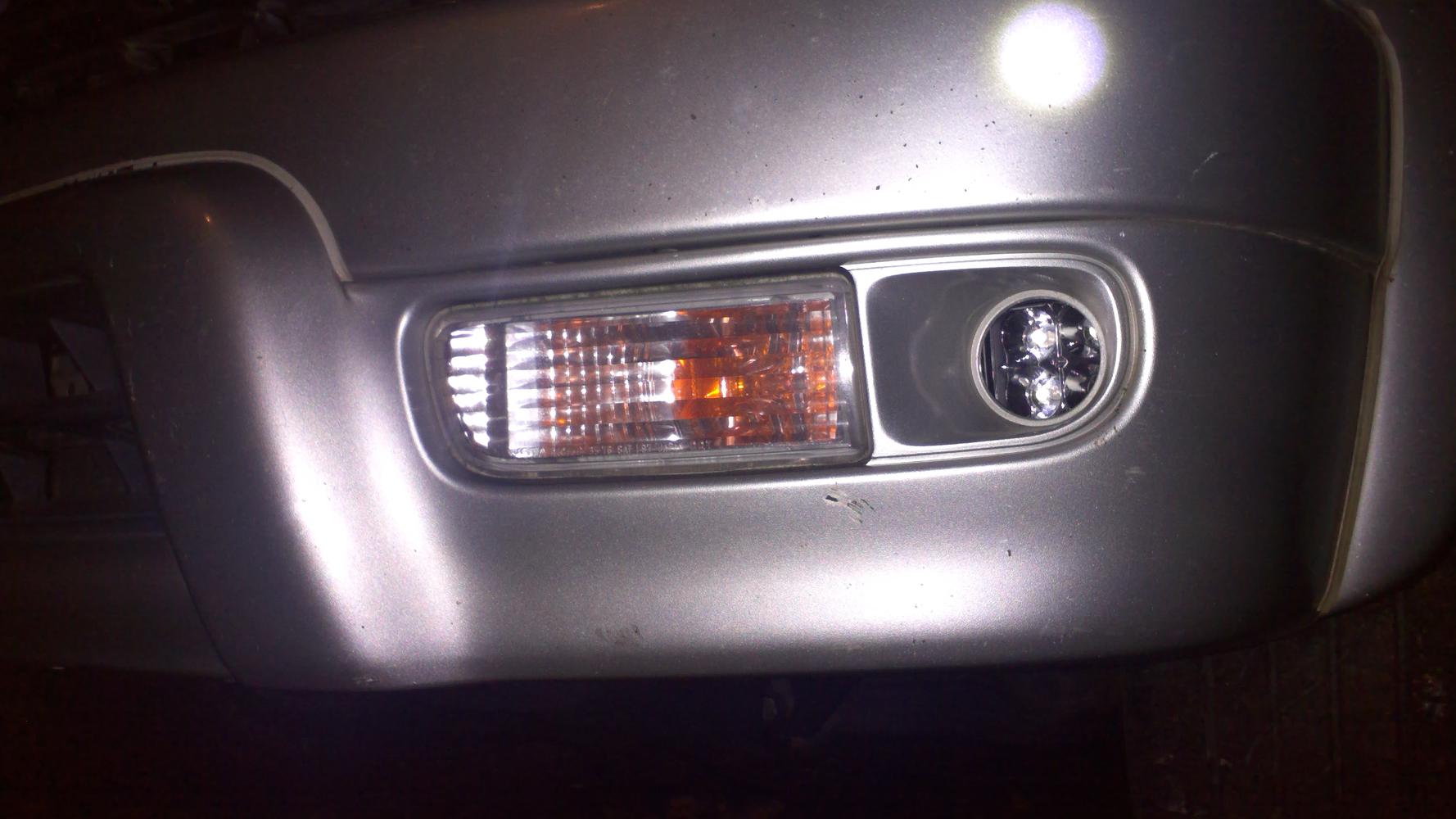

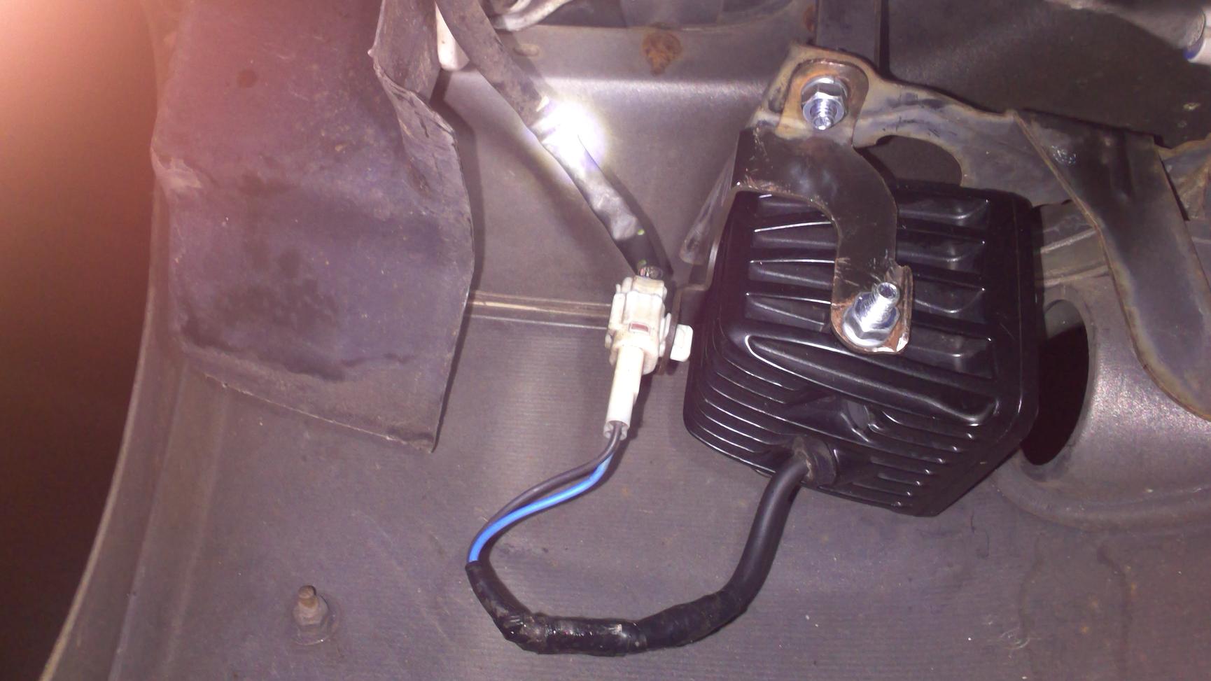

I recommend replacing the OEM fog lights with light pods. I was given two Rigid Industries 2x2 light pods, and they fit perfectly in the OEM brackets. It is amazing how everything went together perfectly and i am surprised at how well everything looks. The lights are probably brighter than any purpose-built fog lights or OEM replacements. You can wire it up nicely, and the best thing is that you dont have to add switches on the inside of the car,
the normal fog light switch still works. Highly recommended, and good luck!

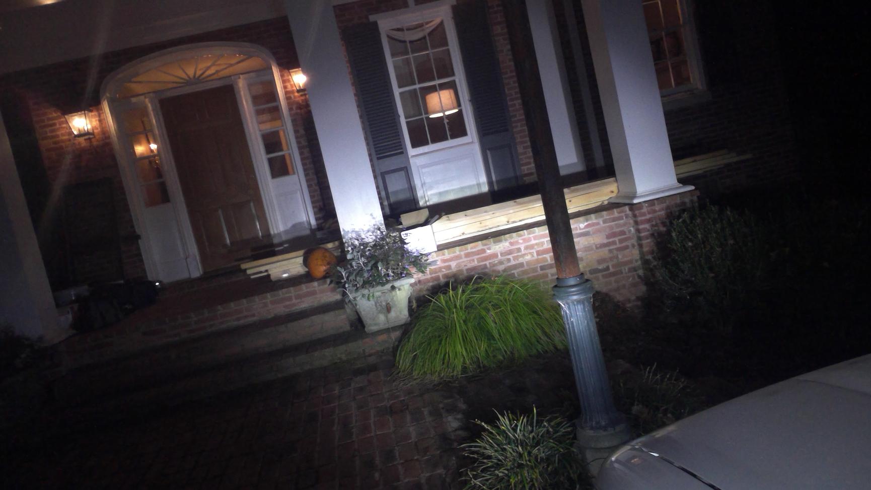

Here is the light output comparison, first without the fogs then with:

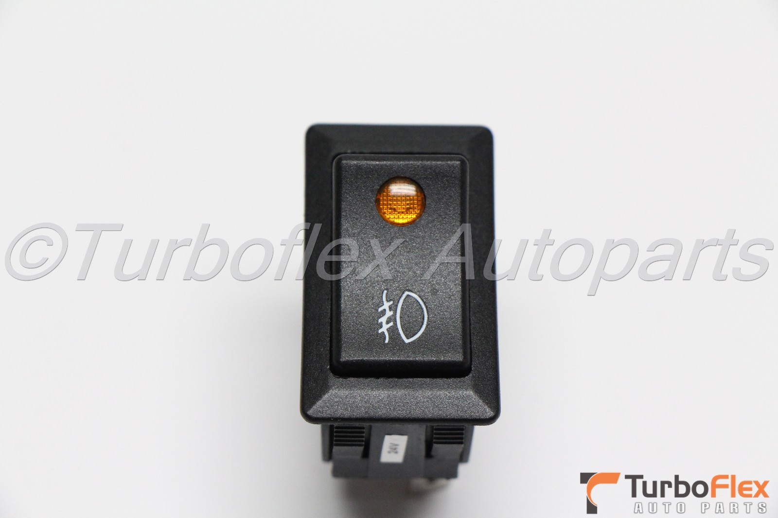

Following this thread and I have a question. What's a good OEM-ish fog light switch that will fit in the standard blank spots on the dash to the left of the steering wheel? I've seen the ones that came with the hella add-on option, but I assume it's also no longer available too.

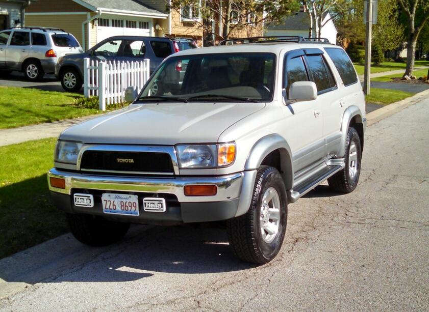

I bought 1 for the 97 puppy hauler. Let me see if I can dig up the info. All I did was google the part number on the switch. Think I paid around 15 for it. It was an exact match to the broken one.
You can look for my 97 Limited Puppy Hauler thread. And see if it's there.
Yes, they sell the original OEM switches for around $15 on eBay. I had to drill a 3/8 hole through one of the blank covers to mount the switch that came with my hella 450s.
Installed the Blazer C8010's floods on the 97 Limited Puppy Hauler. Bought them at TSC. Could have paid a lot less ordering them on eBay etc but wanted now. 20 each instead of 8 or so......
