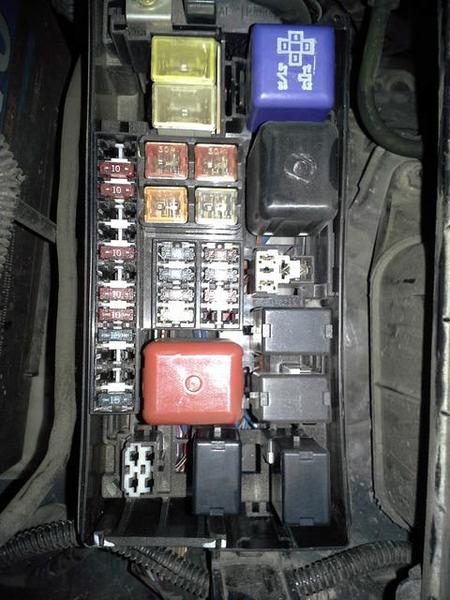

On my 2000 I added the stalk w/ fog light control, a pair of oe fogs, and the relay and fuse in the under-hood fuse box. It is a nice upgrade. Plug and play.
On my 2000 I added the stalk w/ fog light control, a pair of oe fogs and the relay in the under-hood fuse box. It is a nice upgrade. Plug and play.
I’m new to all this stuff so I don’t know how to add relays to the fuse box? How is that done?
The socket for the relay already exists in your under hood fuse panel. Simply acquire the relay and plug in.
