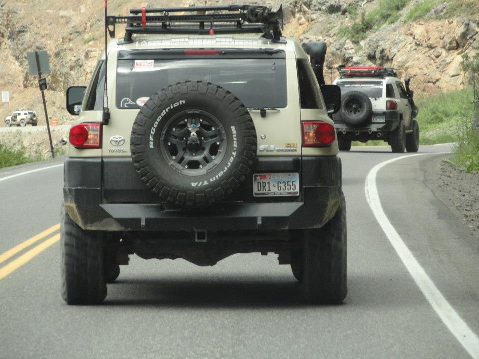

I just pulled a picture of my FJ and it leaned. Or it could be because I was in it too.
