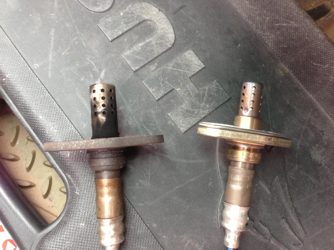

New O2 sensor installed. The nuts were very rusted and rounded off so I had to use an extractor set. The old gasket was completely rusted to the exhaust and I had to chisel it off.
