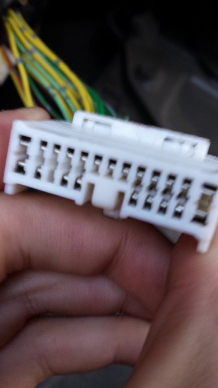

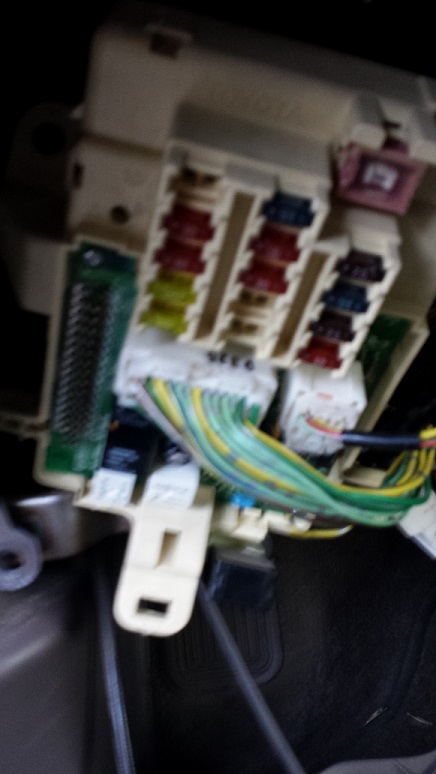

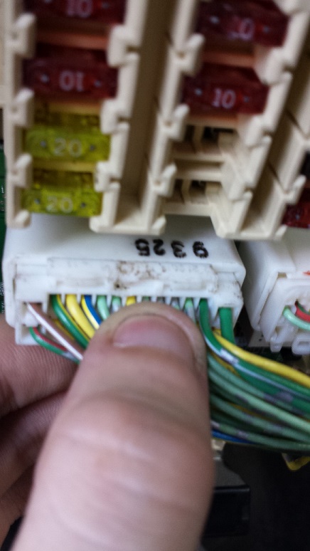

Im having a problem with my fuse box/relays and think Ive narrowed it down to this part. Notice that the 3rd from the left, bottom row socket is missing the small metal clamp that all the other sockets have. Can anyone confirm that it should have a little clamp also?
Anyways, I am trying to replace this plastic socket portion in my '99 without buying an entire wiring harness. It has the numbers 9325 printed on it. It plugs into the fuse box in the drivers side dash kick panel. I am hoping to get a part number so that I can order one.

The number you are looking for is not going to be printed. There should be a five-digit number molded into the connector. The part number for that plastic housing will be that number preceded by 90980-.
You are fortunate that I have a '99 EWD and I can confirm:
That plug is #B16 on the Body ECU. The terminal hole you refer to is T8 and it is unused in this application. #6, same row, next to the tab, is also unused. The rest are used and should have wires/terminals. I can tell you what each wire does if you need help chasing a problem.
The part number for the plastic housing is 90980- 10921. This is JUST the plastic housing, you would have to transfer over the wires and connectors. Repair wires with terminals are sold separately. If you need one (or more), I can look up that number, too, or the dealer can get them. The dealer will probably NOT be able to obtain this part number for the housing as I did, but they can order it for you if you have the number. Some will do it, like mine, but I have heard of some who won't.
90980-10921 - Genuine Toyota HOUSING, CONNECTOR F
In any case, your issue is NOT the missing T8 terminal. Since it didn't have a wire, it may have just fallen out, but it would make no electrical difference.
Well the problem I'm having is a clicking relay on the circuit board. It seems to be related to The rear hatch. The dome light turns on/off when the relay clicks, and my rear window and wiper work intermittently.
Pretty much has to be the PWR relay, back side of where you are, top right corner looking from the back. I'd check your 30A PWR fuse first--the big one in the top right corner--it may be semi-burnt and passing current intermittently. The second thing to try is swapping the PWR relay itself. If those aren't it, then you have to trace the ground and power circuits to the coil of the relay. Check the fuse and relay first and let's go from there. The PWR relay and the EFI relay are the same. The EFI is a worse place to have a bad relay, but you can swap it for a test. If fuel pump cuts out, swap 'em back and get a new PWR relay.

This kind of smells like a ground problem. Has any work been done under the dash recently? Stereo install or the like?
Also I'm pretty confident that the clicking relay is one soldered to the circuit board. Not an external one. Still think its the power relay though?
Hmmmm. I thought you meant an external relay was clicking. Sure, it could be something internal to the Body ECU. That would make sense, actually, since the PWR circuit has nothing to do with dome lights, but the Body ECU controls those as well as the signals to the rear window and wiper. This is tough to troubleshoot, as we don't have internal diagrams for the ECU's, they are just 'black boxes'.

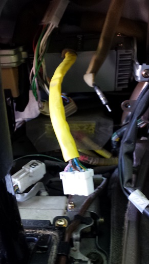

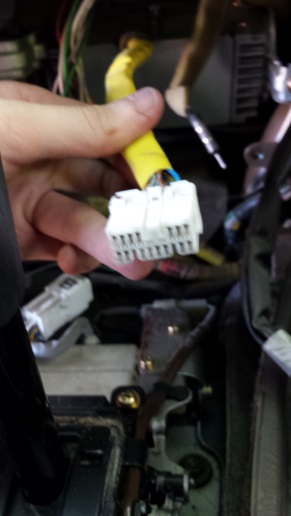

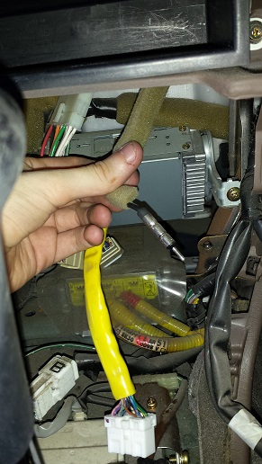

Turns out I might not be able to get that replacement part... So I dove further into the dash today to try and diagnose the problem. I found these two just hanging out, not plugged into anything. Any idea what they are?
Bottom one is the diversity antenna (wires embedded in the rear glass--I forget which side of the cargo area).
White one looks like a stereo amp plug. They may have abandoned the stock aux. amp in place when they did the stereo install. So those probably are not your issue.
Ground wire from the Body ECU is White/Black. It goes to a small 4-wire junction (all white/black) near the steering column. Look for anything funky on those wires: Taped joint, Scotch-lok, etc. that could have been done by an installer. If you find one, consider it a prime suspect.
