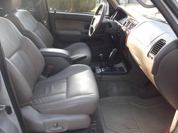

'98. The vents on the dash should have the clock in the middle, not off to the driver side, and the cup holders are clearly visible under the vents. The Hazard switch is also located in between the Vents, and is not there.

98 for sure. It has the old style instrument cluster without the digital odometer that started in 99 and that wouldn't be an easy swap.
Well... paid the $80 for a very revealing carproof report. Turns out its not an immaculate 1999 with 200k for $6800, it's an 1989 with 'Rebuilt/Rebuildable' title and $20k worth of insurance claims over the past 10 yrs. Ugh! When I called the guy back he pointed out that he didn't 'hide' the rebuilt title from me, and "98's are the same as 99's you know".
