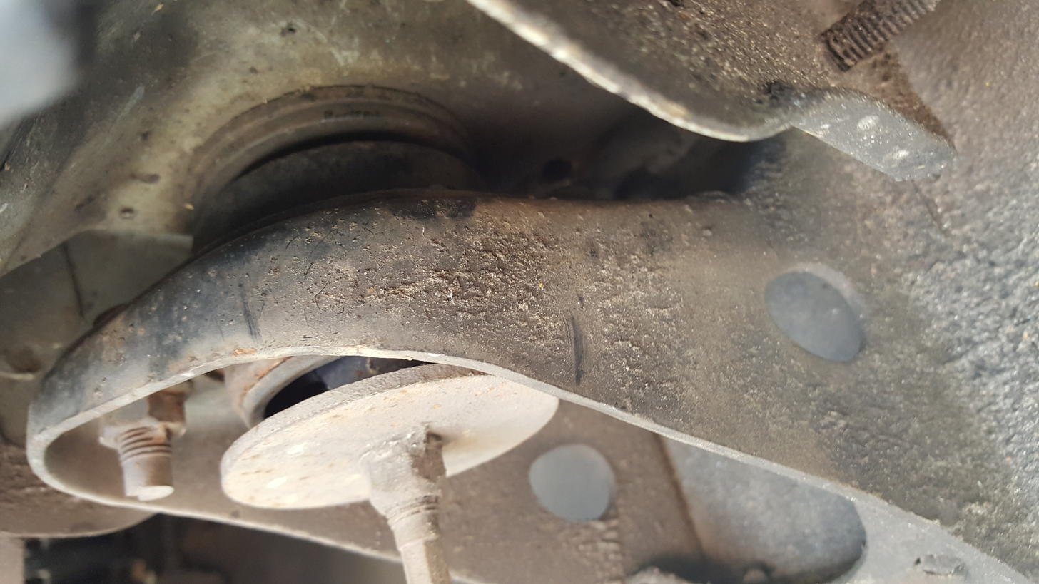

So you have a 99 with October production date? Interesting, I didn't think they went that late in the production yr and that would make it a 2000. Now does your A pillar body mount (2nd one back from front) have the collar plate with 2 bolts? That's the newer frame update. Although not sure how much a difference you having a 2.7 and me with the 3.4 would make with the production frame change, maybe this didn't happen with the 2.7s.
I checked. The 2.7 pulls up the same diagram as I posted back in my first post for my V6 rig. I too would be surprised at an October 99 date for a MY 99. 10/98 would be MY 1999, but that should be the old format like mine (03/99).

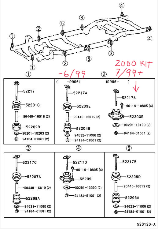

Just to make sure my 99 didn't get a frame swap from an accident or something, I verified vin on frame inside passenger side front wheel well. Frame vin matches body vin. Double checked my title, its a 99 title, verified 7/99 vin sticker production date. So its all a legit oddity.
So the frame diagram you showed, is that a true 99 specific diagram where it shows a choice of 2 possible A pillar body mounts for 99 only? Or is that a multi year frame diagram?

Ok I see how they word it, have to read into it a little theior code, full understanding now ( -9906) and (9906- )
So I would figure the frame bracket a little different to, but ooh well.
OK so I think this was good this all came out, this is something the aftermarket body mount companies need to put in the ordering section. (manufacture up to 6/99 or 7/99 and up)

The diagram is multi year, but the parts list associated is VIN specific. If I click on part 52203E, then the parts list will return the correct p/n for that VIN. So my 03/99 comes back 52203-35200, which is the one on the left. If I do a generic 2001, I get 52203-35250 which is the one on the right.
Try your VIN at TOYOTA | Japan Parts EU and see what you get when you click on 52203E. I'm curious.

Came back as not a correct part, maybe I'm doing it wrong here it is JT3HN86R8X0255244
Ok so this is what we figured out thanks to my order mishap and the input from TheDurk frame diagram he provided and frame swap findings. This all relating to the frame changeover date. The A pillar body mount being different on the frame change. This looking as accurate unless there is something that can be found to the contrary.
3rd gen Body mount bushing kit order as follows -
***up to 6/99 production date order the kit that is 1999 specific
***7/99 and up production date order the kit that is 2000 specific

I'm guessing this:
9906- can be interpreted as after 6/31/99, or rather the last day of the month.
-9906 can be interpreted as before 6/31/99.

I'm guessing this:
Yeah I think so. But if one wants to make sure, a simple look at the (A) pillar bushing will determine correct one.
***(A) pillar bushing sleeve/collar with 2 bolts = newer frame 2000+ kit
***(A) pillar bushing matching (C) pillar bushing = 1999 kit
