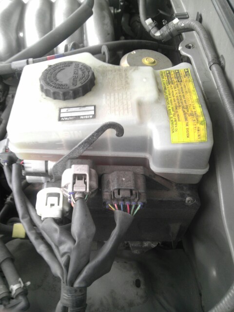

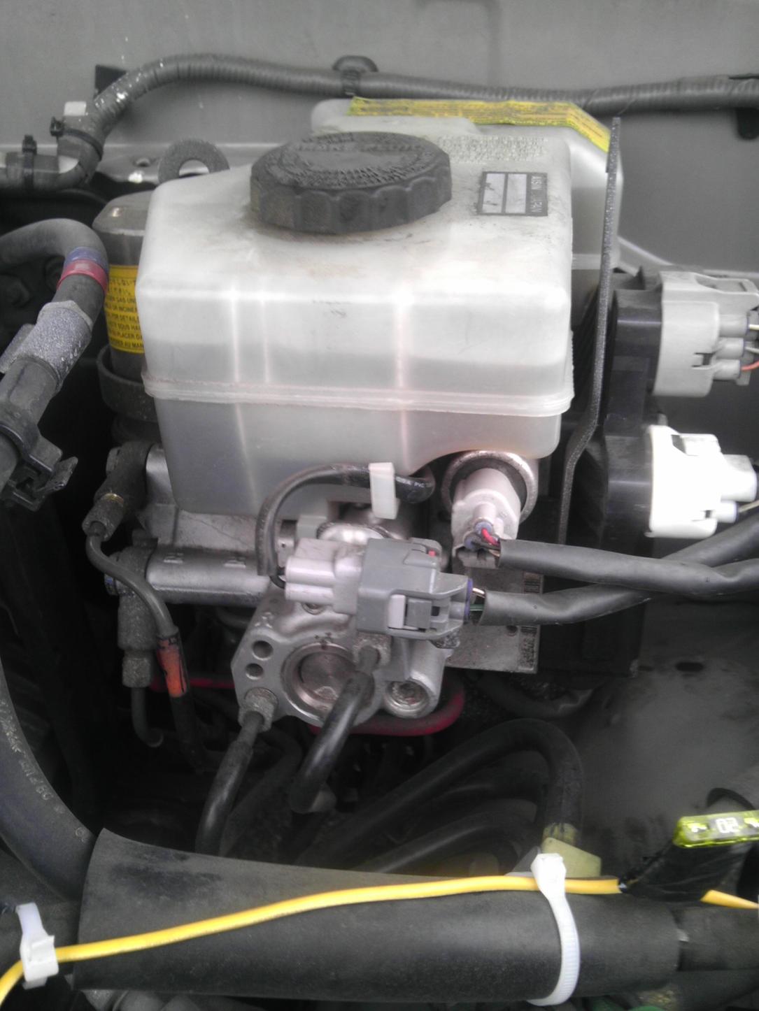

Does anyone have any new ideas? Over the past few days i have been listening to the noise under the hood trying to pinpoint the area it is coming from. Im pretty confident that it have nothing to do with the ac blower. I feel like it has something to do with the braking system. The problem is i dont know what part. The brake booster is my first hunch. I dont know all the proper terms for what the 4runners have as far as brakes and would like to know (if someone could fill me in) but i am quite sure that the problem and noise lies in the braking system.
I think that the noise has something to do with the attached pictures (under the brake fluid bottle). I'm not a mechanic by any means so i don't know what to call this. I'm assuming its the electronic brake something or other.

So the noise happened again today... Surprise surprise. However i was able to get a better idea where the noise is coming from. I left the key on the ON position and let it do its thing when i first start it. I popped the hood and waited for the noise to start. When it did i found that it was coming from the picture i posted. I put my hand on one of the canisters that is blow the brake fluid bottle and could feel the vibrations from the noise. I feel confident that, that is where the noise is coming from. Thoughts?
I have a set of newly acquired FSM's let me look and see if I can find anything. It sounds like you've found the source of the noise.

Your year runner has an electric motor for brake assist rather than engine vacuum. Just next to the master cylinder is the motor and it will run when you first turn the key on to build pressure and will run intermittently while driving to keep the pressure built up.
Just an Idea. A picture was posted of the master cylinder and there is an electric motor there.
When i first turn it on (first start in the morning only) it will cycle through five or six times. Is that normal? Throughout the day it only does it once. In the morning is when the weird noise occurs. Unless i pump the brakes a few times will it not happen. I think i need a new brake motor. That's my thought anyways. Every mechanic wants me to bring it in and leave it overnight. The noise doesn't happen everyday so i have a hard time actually doing that. However, i realize that it cant be fixed if i don't do that. I'm just hoping someone on here will have had the same problem and tell me their experience. Thank you for the reply though.
If you turn the key on, but don't start it you should be able to quickly move your ear near the master cylinder to see if that's where the noise is coming from. The brake motor will run when you turn the key on. Mine runs continuously for probably 10-15 seconds, stops for a bit and then runs again first thing in the AM. As I drive and use the brakes every once in a while I can here it running. But not much over the sound of traffic, the radio etc.
