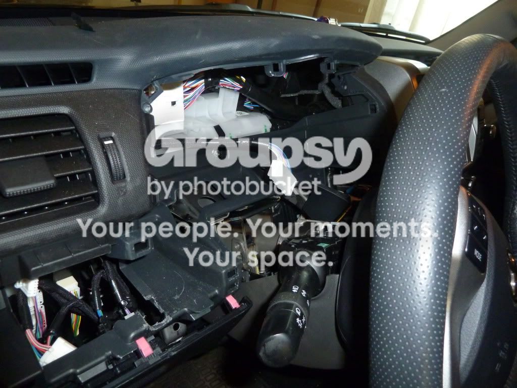

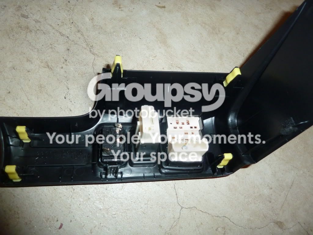

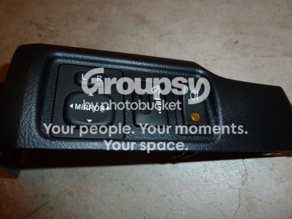

No need to dermal or take your gauges out but this should give you some idea.

Glad to see it DOES come out without removing the other panels. I could've sworn it was like that but I couldn't remember positively so I didn't want to point OP in the wrong direction.

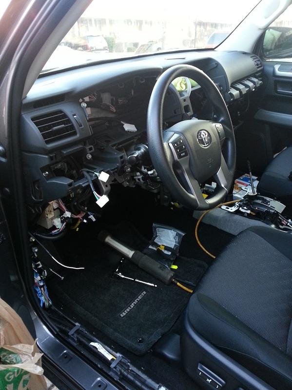

This is how my interior looked like when I pulled out this panel in question, hence why I had no clue what order the panels come out, lol.
