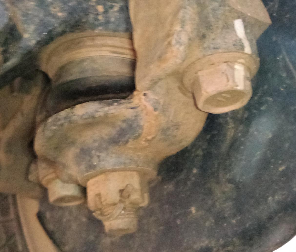

Really, you don't think a mechanic should do the ball joints? Also, is there a way for me to visually evaluate whether or not they need to be done? Any warning signs?
Take the castle nut off. Remove the two bolts from the part the ball joint is secured by. This is one design that Toyota got right. It's super easy. Grab the stem of the ball joint and move it around it shouldn't move easily. Their should be resistance but movable by hand. I'm sure it's the tie rod end links though due to the tire wearing in that particular way,. Your shakes when braking are another symptom the links. Refer to my previous post.

I don't know why you keep posting 5th gen specific repairs and procedures here in the 3rd gen section. It isn't the same. It's barely an apples and oranges argument. 3rd Gen lower ball joint is attached to the steering knuckle with 4 bolts (there's 2 different lower ball joint bolts and torque values depending on what bolt it is), there is a castle nut and pin where it attaches to the lower control arm, and another castle nut and pin where the outer tie rod end attaches. Please refrain from posting repair procedures that do not apply directly to 3rd gen 4Runners since this is the 3rd Gen 4Runner section.

To further correct some of your misinformation, steering wheel shaking when braking is a sign of front rotors that have excessive lateral runout which is commonly referred to as warped rotors. It can also be caused by hot spots or glazing on the surface of the rotor causing a slip/grip situation for the brake pads. It's very rarely caused by worn tie rod ends. Worn tie rod ends typically cause a loose steering feeling and a change in toe which usually presents itself in bad tire wear patterns.

I think the brakes vibration is from the brakes themselves. I was told that I've been going through my tires, wearing the outsides of them, because of the control arm bushings. You think that's not correct?

I read your entire post. I also looked at the photos of his tire wear. Based on those photos it's not likely to be loose tie rod ends causing the minor amount of tire wear. Like I said the most likely cause of shaking while braking is indeed a problem with the brakes. Loose tie rod ends will be all the time not just while braking.

It could be numerous things. I usually just jack the front end up and start checking all the balls and bushings by shaking them around with a good amount of force looking for play. You can use a crowbar also to move the joints around looking for play. Be careful with the crowbar! I move the steering wheel back and forth to listen for weird clunks also. Just some quick checking.
