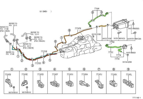

Well, here is the schematic for an '05 V8 (I verified that part #'s for the parts in question are the same for both the 4.0 and 4.7).
Good luck!
I'm guessing by the fact you have the L4 Connector that you have an '06 or newer (thankfully otherwise it'd be a pain to hunt the part numbers down.)
L4 Connector [PN: 90980-12380]
The Pins are [PN: 82998-24250 & 82998-24260 (for the Gold Plated Terminals if it has any)] They are 0.64 (Waterproof Type) Terminal, I haven't figured out how to hunt individual terminals down by that identifier yet; but there it is if you're curious.
The Rubber Grommets that seal the wires into the connector are: [PN: 90980-09871]
